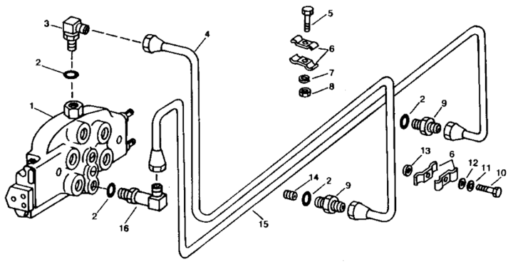

Looking to put hydraulics on my wife s JD 1450 for hay raking purposes. No luck at dealers. Can anyone suggest where I could find a hydraulic kit for this tractor?

The John Deere parts website shows parts for a full two-valve
control system but not as a kit. A salvage yard might be able to help.
A Yanmar dealer might be able to provide parts.

Photo below shows factory valve. Be sure to install pipe plug(key 14) when attaching a valve. Any brand open center 10 gpm spool valve should be fine if factory valve can't be located

Thanks so much for info. Is the pipe plug only used on supply line and not return line? Is this plug often missed in the
installation?(maybe from your experience) I m going to check Worthington for this valve but not sure it would be worth the long trip
to get.

Thanks for info! Does this 2-valve system provide a single remote hydraulic (2 hoses) or dual hydraulics for 4 hoses?

2 spool will operate 2 hyd circuits
