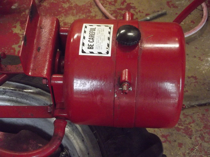

Hi, I have a 1940 Farmall B tractor with a hydraulic front end loader bucket on it with a char-lynn pto hydraulic pump hi-lo-pac pto unit. I am looking for were I can get parts for it! What I am looking for is what they call the cushion shock spacer at the pto drive coupling. Any help with this would be greatly appreciated. I have some pictures of the char-lynn pto hydraulic pump hi-lo-pac I need the shock spacer and looking for a new handle. Thanks. Bill

here is a picture of the char-lynn pto hydraulic pump hi-lo-pac pto unit

We had the same pump on our OC-6, and couldn't get any in the late 70's. Ended making a multi layered replacement out of semi tire side wall. PITA, but it kept it working.

Pretty sure parts for those are long obsolete. I made a similar coupler. Had a local water jet cutter cut me some from a thick chunk of rubber belting.Just made a 'traceing' of it,and the water jet cutter did the rest.He even made me a coulpe extra. Cost was very reasonably.

Try a Lovejoy coupling, they have "jaws" with a rubber? coupling/damper.
