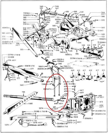

The arms on my 8N (2N rear end) dropped the other day and won't raise at all. Can lift them up and down by hand with no resistance at all. Doesn't matter if lift control is all the way up or down, PTO engaged or disengaged, PTO is working. Any ideas on where to start? Hydraulics have been knocking a little sometimes when raised and under a load.

Insure that the control arm moves when you operate the touch control lever. Reach in w/ the tractor off and insure that the control arm is attached to the pump. If that does not solve the problem, put a heavy implement on it, turn the tractor on and try and lift the implement.

Does your 2n rear end have a 2n pump and top cover or an 8n pump n top cover? Diagnostics will be slightly different for each.. For instance if a 2n pun n cover, pull inspection cover and look at the control fork and t valve.

When you pull the inspection cover, the one with the dip stick, follow the control rod with you eyes or hand down to the pump. If there is a T with one control valve that is a 2N pump. If there are two control valves down there that would be an 8N pump. If the control rod is working the valve or valves in and out then you can start the tractor and watch what's going on in there when you move the control lever up or down. Look for leaks etc. The knocking sound under load in normal for the Scotch Yoke pump.

OK, that means your lift is of the 9/2N variety and only has Draft mode. Position Control became available with the 8N by using the small lever shown in CaryC's pixs.
You will have parallel control arms/rods (504) that attach onto the "T" shaped control valve (640) in the diagram. Previous advice was to verify the control rods are firmly attached as this connects your touch control lever to the hydraulic pump.

Not necessarily. My 8N has no Position / Draft lever on it either. Would you like to guess what is inside that rear end?
For your information it's the single control rode as in the 8N's. The only way you can be sure of what's in there is to remove the dip stick inspection cover and look inside.
