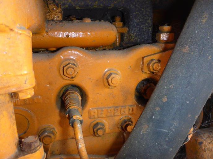

You have a late 1946 RTU. They switched from magneto to distributor ignition at serial # 414456 in mid 1946 production. 38" rims were optional on the RTU during that time frame. The small fuel tank mounted under the hood is the gasoline starting tank. This was used on tractors equipped to run kerosene or low grade tractor fuel at the time. What cylinder head casting is on your tractor? RE 226C is the common gasoline head. I suspect yours may have a lower compression head. We have an RTI industrial with that extra tank. It's not an option you see on very many R models but I can understand why it's on yours given it was likely an export and right after WWII fuel quality may not have been the best. It's unknown if your tractor was an export model from the factory or just ended up that far around the world since MM records from that time are not readily accessible to reference.

The head number is RE226D. So hopefully help identify the motor details.

4) Engine head casting number.

That is the correct low compression head for your tractor. Moline always used a separate serial number on their engines since they could be stand alone power units or used in tractors or other equipment. Your engine is a model EE which is correct for the R tractor. The model RE engine was used in the ZT tractors. You'll find several parts of the engine cast with "RE" part numbers as the EE and RE engines shared many parts but the RE engine was developed first.
