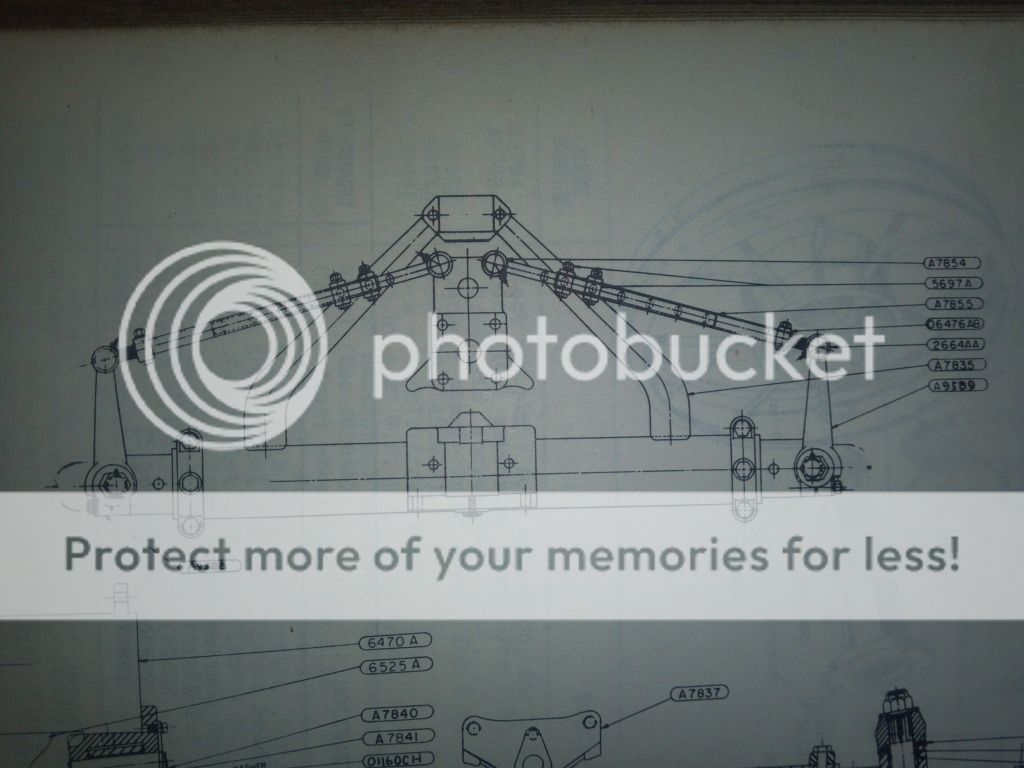

Chuck, I'm looking for this setup.

I am not at home right now but would you know if a9589 was
use on early 830 Case o matic ,and if so I would most likely
have. Shoul be back home on March 22. Jc

I have seen this front end show up on other tractors but it was originally available only on the first year of 400 production, prior to serial number 80696**. You would have to look and see. The LH steering arm is similar to the regular WFE but the splines are broached a little different.

1031D,It looks kind of like a SCHWARTZ axle maybe you could adapt those parts.
SCHWARTZ axle

Looked into that too. SCHWARTZ axles were keyed spindles these are tapered splined. I have the center piece and tie rods, just need the arms.
