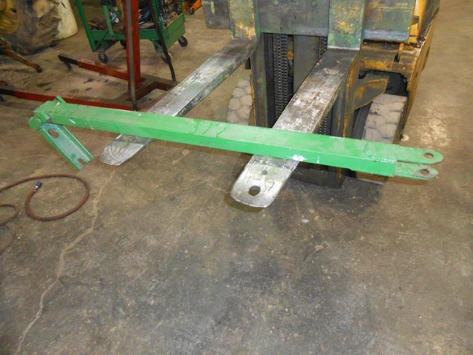

Yes, you can have somebody go along and kick the tires to steer them as you go. But I made a tow bar that bolts to the two holes at the bottom of the pedestal with a pivot joint and a tongue. I can hook on to a tractor and tow it around without a second person and it follows perfectly.

I have a hitch set-up that bolts to the 2 holes in font of the roll/matic, sorta looks like a short wagon hitch, that works well for this.

That seems to work the best, I rebuild a '49 B for my daughter, it was stuck when we got it & had to be pushed in & out of the shop countless times. When it was all done I did the same thing, built a hitch on the roll a magic. You have to pull the steering shaft or the gear on the top of the pedistal but I'm able to take her through the parades with one of the other tractors. Hers is a flat plate & square tube welded together, then I have another piece that plugs into the square tube so they can get pinned together.

PostPosted: Sun Mar 24, 2013 4:32 pm    Post subject: Re: Moving a tricycle with the steering shaft out Reply to specific post Reply with quote
Here"s a pic of mine..

Mine would look simalar, from old scraps at work. I have a 2" ball hitch on one end, the main bar is a solid 2"x6" that"s drilled for the hinge like yours. Then the other side of the hinge is 2" square tube that I put slugs of 1 1/2" bar in at both ends, the hinge end only has enough bar that the bolt won"t wear, while at the other end has a stub sticking out so it will plug it the part onto the 2" on the tractor. Actually just brought the tractor to my dads tonight behind the truck, tows easy, colvers were a little hard on the truck though. I"m thinking of building an adapter for the none roll a matic, aswell as one for going over the draw bar of a dead tractor. These will make things a lot easier & more uses for the hitch. Sorry I don"t think I have any good pics of the hitch. Works great & made from scrap metal. Kevin

Mine is kinda light duty, I would never move one on the road with it, it"s just for moving around shows and at home.
