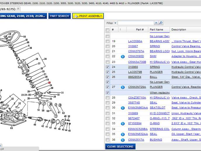

Hi, I new around here, Hope you guys can help me out.
My fathers 3400 was leaking PS fluid up the steering column and out from under the steering wheel. He had someone change the seal for him but when he got back it would steer to the left but no power to the right. So this is where I got involved. I have disassembled it down to the control valve and noticed that it has 4 springs and 8 thrust plungers. there are no reaction plungers and ball bearings in the assembly.
Could this be the problem or do I need to look deeper?
The New Holland parts catalog shows my missing parts as discontinued and replaced by a spring and thrust plunger.

PostPosted: Mon Apr 08, 2013 3:54 pm    Post subject: Re: 3400 Power Steering Problem Reply to specific post Reply with quote
Ultradog
The LA33579B Plunger is the same as the other plungers in the valve. The NH parts catalog calls out 8 ea LA33579B plungers and 4 ea springs.
This is what I have in my control valve currently but she don't work. Which brings me back to the original question. Is the 8 plungers and 4 springs the correct configuration or is the NH manual mistaken.
Has anyone had any luck with this setup. 8 ea item #25 and 4 ea #24. the picture was cut on the right side.

PostPosted: Mon Apr 08, 2013 4:15 pm    Post subject: Re: 3400 Power Steering Problem Reply to specific post Reply with quote
It has been a while so bear with me, the fact that it worked one way and not the other leads me to believe that the parts are not the problem.
When you turn the steering wheel, the spool (round part) that is in the center of the control valve moves up or down depending on the direction the wheel is turned. When it moves, it directs oil to create the hydraulic assist in the steering system. Something was not allowing the spool to move in one direction, possibly something not assembled in the correct order, or the nut that is staked to the shaft being too tight.
Question-was the washer between the nut and the spool a concaved washer? If it was, was the dished side of the washer towards the spool? It should have been. If the washer was not concaved-that IS A problem.
There is a groove in the spool (on the inside of it I believe) that should be towards the top of the control valve.
The nut that is staked-only tighten that enough to put some preload on the concave washer, not to collapse the washer or the springs in between the plungers-which now that I think of it-I would bet was the problem.
Sorry for the long post, I know it is a lot of info, but I hope it helps.

PostPosted: Fri Apr 12, 2013 9:06 am    Post subject: Re: 3400 Power Steering Problem Reply to specific post Reply with quote
Here is what I have found so far.
The concave washer and nut were fine. Did not appear to be over tight.
The spool and bore of the valve were galled enough that I had to use a hammer and drift to get the spool out. I cleaned up the high spots on both parts and now the spool slides freely. The plungers all move freely in their ports and all passages in the valve are open.
I re installed the valve, thinking the galling was the problem, and still have no power assist to the right side.
I am waiting to hear back from the guy that changed the seals to see if he has the two plungers that go with the ball bearings somewhere in his shop.
Question - could it be an internal leak on the right PS cylinder? There is no sign of it leaking externaly.

PostPosted: Mon Apr 15, 2013 5:25 am    Post subject: Re: 3400 Power Steering Problem Reply to specific post Reply with quote
Thanks to everyone for your replies and ideas.
Here is my update - I am still fighting with it.
With the front end lifted off the ground the wheels turn fully left and right so I do not think anything in the steering box is out of sync.
I swapped the cylinders left to right - no help, so it is not a cylinder. I swapped the lower hoses left to right - no help.
I reversed the spool - put the groove to the top and that seemed to make it worse. With the groove on the spool on the bottom it seemed to have a little assistance from the hydraulics.
The washer on the top of the upper bearing is in good shape and still concave.
I was tightening the top nut down until the bottom of the upper race made contact with the spool and then backed the nut off @ 1/6 of a turn. This did compress the plunger springs a little but had little effect on the concave washer. This is my best guess of the IT manual instructions of "Remove End Play and back off 1/6 turn".
I spoke to the guy that origanally changed the seals and he said it had plungers and springs in all the holes.
Sorry for the long post, I will let y'all know when I am ready for a manual steering conversion kit. Smile

PostPosted: Thu Apr 18, 2013 4:10 am    Post subject: Re: 3400 Power Steering Problem Reply to specific post Reply with quote
Latest update -
The needle bearings at the base of the shaft were shot and I suspect the trashed needles were preventing the shaft from going down the extra 1/16" or so to let the passage in the spool open for flow.
Parts are on order, I will let y'all know how works out.

PostPosted: Mon Jul 22, 2013 3:19 am    Post subject: Re: 3400 Power Steering Problem Reply to specific post Reply with quote
b00tleg82 wrote:
(quoted from post at 13:08:25 07/19/13) I was recently disassembling my steering control valve on my 1969 Ford 3400 to replace the lower oring and fix a fluid leak through the steering wheel with a speedi sleeve and new oil seal. Upon examining the control vavle and plunger i found a "horn" type plunger with 2 of the horns broken. After many hours googling I found what seems to be the horn plungers were replaced by the regular plunger and spring in all the parts manuals. Does anyone know if this is correct and if the regular plunger spring setup will finction the same if replacing the horn and ball plunger? Also i noticed the regular plungers seem to have a beveled edge and square edge does this matter when reassembling? Square edge toward spring or the other way around? Thanks so much in advance!
Sorry for not replying sooner, my son took me fishing this weekend.
With my valve assembly, I re-assembled it with 4 spring plungers and it works fine. I did not notice a beveled edge on any of the plungers, you might be able to see a slight mark where the spring made contact. But I do not think it will make a difference.
