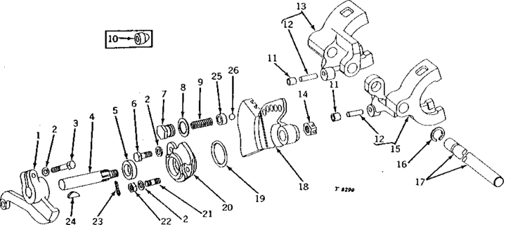

can anyone tell me what holds the synchronizer clutches in there drums the 2 front ones

The clutches are retained in the drums by the shifters(parts keys #13 #15)

my clutch plate on the front 2 drums come out and get between them

Either the drums or shifters have too much wear or probably both are worn excessively.

Sounds as if you have an I&T manual which is not near as informative as the tech manual I listed. If you're going to attempt to repair the trans syncronizers it will be much easier for you if you get the JD tech manual. It's been a long, long time since I've seen one split but I'm fairly confident one can split the trans from clutch housing with clutch housing still attached to engine. I think the 2 bolts(parts key #27) must be removed through trans top cover hole.
