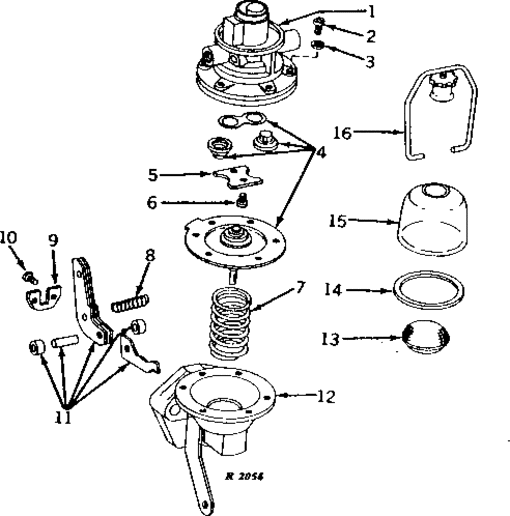

My father has a John Deere 4010 tractor. He asked me to see if I could find a way of changing the fuel filters without having to bleed the fuel lines afterword?
Looks like 2 green metal canisters facing each other. Somebody told him to look for the hand pump?

Just change both filters then open bleed screw(parts key #10) on top filter then pump lever on lift pump to purge the air. When diesel comes out of bleeder,tighten bleeder & crank engine. If when pumping hand pump no resistance is felt bump engine a little to get cam lobe away from lift lever.

Can you direct me/him to the lift pump lever?

Lever(parts key #6)
If it has original pump.

If you can't find the lever they sometimes break off or someone could have installed a fuel pump for gas tractor.
