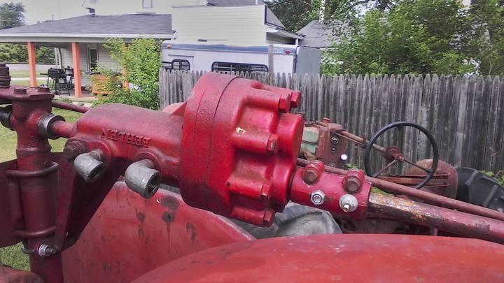

Well, we finally got the 971D Select-O-Speed finished and the front loader is on as well!
She starts every time we ask her to and works like a mule. We sure do love this tractor!
Now a question:
We want to go with a wider tire up front. The 6.00-16 3-rib ag's just cut into the mud too much and make things difficult. Does anyone know if there are wider, commonly available rims out there that will fit the 901 series and allow me to use passenger truck tires? We don't need weight holes, that front loader is beefy enough Smile
I would put them on the existing rims but they seem rather narrow for the truck tires I have in mind (may work but did not measure).
Thoughts?

2 options. put truck tires on wide implement rims.. or buy multi rib tires instead of them pesky tri ribs.
i have an 850 with truck tires on it. if you have ps and a loader.. probably not bad.
i have an 850 with muklti ribs on it.. no ps.. but does have a loader.. but now has a hoe too.. so not too front heavy....

I have 6.50x16 tires on my 640.They run close to the spindle.You will have to change rims to go wider.

Hmmm... Found some 8x16 wheels with the 4.62" center hole... $113 each. Ouch! That's almost double a standard rim.
Think I'm going to look for some 6x6" bolt circle road equivalents. I can get those for 10 bucks ea.
If anyone knows a match I'd certainly appreciate it. Would save me mucho research time Smile

As to the front tires, I think I would just keep the
rims you have and put some summer truck tires on.
When I first got my loader tractor years ago, it had
those (see pic above)and they worked OK for most jobs. If I remember, they were 6.50x16. Of course you have a different front axle, but with the wheel dished-out it should work. Not wider but won't tear up the turf as much! -Will

If you have a boneyard near you with some 5000/7000 size Fords you could buy the front rims used. 16", same hole size and bolt pattern as your 901 but much wider.
These were on a 4000 that I bought. I sold them.

take your measurements carefully at the scrapyard.
16" wheels are so common, there are lots of variations.
I have a 850 with 6.5x16, lots of clearance on the right, left rubs.
a casual glance says both wheels are the same,
but a tape shows a slight difference in offset.
like said, truck tires are best. I've had multi-ribs with their
'round' tread profile and they steer very easily, but
are useless in snow or clay mud.
Multi-ribs also have a bigger sidewall bulge at the same pressure and rim width.
