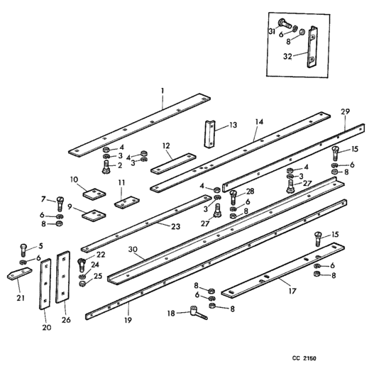

I have a JD 24 T baller on a farmall M and am baling in 1st gr at open throttle. My windrows are small. I have the bale tensioners tightened to the limit, but can only get a 35-40 lb bale (perfect in all respects otherwise).
I"m sure the problem is small windrows, but I wanted to check here to see if there were any other solutions, other than increasing speed or re-raking the hay.

Wally
I think you could attach the 24T to the largest pto HP built with 540 rpm pto and it won't affect the weight of the bales.
Yes larger windrow will affect the weight and installing wedge restricters(parts key #32) will make bales heavier. I didn't see wedges in a 24T parts catalog but I see no reason they couldn't be installed. New resisters that resemble a cabbage grate will help but not as much as the angle wedges. I've also seen the side resister doors installed on balers that didn't have them from the factory

I think that Gordo has hit the nail on the head! If your hay is very dry, you can make the bales tight enough to break the strings, and they still won't weigh much over 40 lbs for a 36" bale!

Depending on the baler, you should be pushing out a bale with 10-14 flakes in it, or plunger strokes.
You must be getting 30 or so?
Myself, I run 3/4 throttle, and as fast a gear as the baler pickup will eat. Always get better bales with an almost too full throat than too empty.
