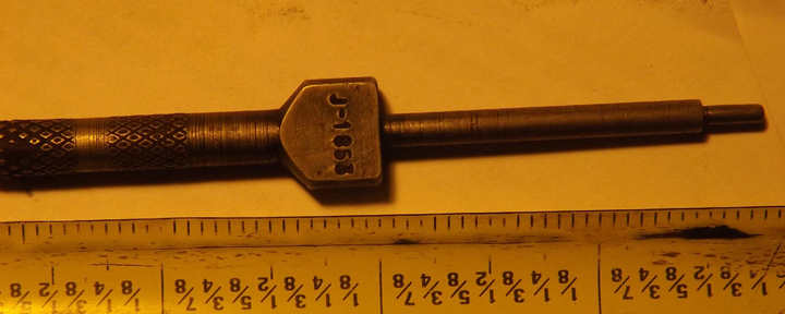

Not sure on the series but I know the head was gone thru by a Detroit service shop. Mainly need to know where to find the special injector gauge tool

DD or eBay .

TIMAR wrote:
(quoted from post at 16:56:56 09/03/13) Bought a 435. Engine has a new kit in it but starts hard and runs erratic. Have the Detroit manual but need to find a few tools like the gauge for the injectors and any helpfull advice. Overhauled several JD engines but this is the first Detroit setting the valves and fuel rack
The tool you need is easy to make. I still have a bunch around that used to cost $5 each. I'm sure a lot more now. You just need to know which inch-size tool you need. It usually goes by the injector/pump numbers on the engine. I don't recall off-hand which one the 2-53 uses in the Deere. It might be this one - and it has a 1.460" depth. That is why it's marked 1.460 on one side and the J-1853 part # on the other. I've got half a dozen in different depths. The bigger part of the two-step shank is approx. 1/8" diameter and the smaller part on the end around 1/16" OD.
