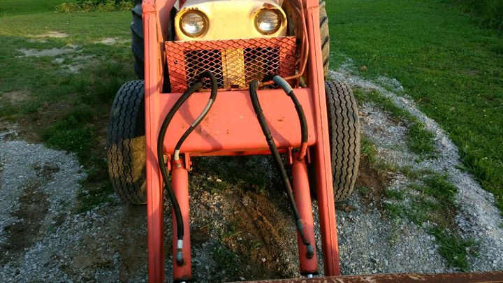

Picked up a '67 550 Oliver four or five years ago, everything working great except the front end loader no longer goes down. No specs on loader anywhere....has two one way cylinders and a cable to dump bucket. Lifts just fine, but had to turn off to lower bucket...now it keeps going up very slowly when running. Suspect the controler unit is leaking around O rings or something similar..anyone ever seen or heard of a comparable loader or controler problem. Would sure like to have some controler specs before tearing into it...but no lables/plate on it anywhere...

I don't think it is a factory loader....I know what you mean about the one's that run off of a forward PTO sort of arrangement, this one has a controller on the fender to the right of the driver and hoses run down the hyrdaulic pump under the seat...please see picture. Thanks.

Have added a couple of pictures....am pretty well convinced that the problem is in the controller as it goes down nicely with the engine off...but will not go down at all with the engine running and in fact slowly goes up a bit...just would like to have some sort of schematic or diagram before tearing into the darn thing.

Hoses come right out of the tractor's hydraulic pump and run to the control and back to the tractor... controller has only four lines...the two going to and from the tractor's pump/system and then one hose to each side of the front end loader, e.g, no return line from the loader hydraulic cylinders...... the controler only has two levers...one to each cylinder...pull back on both and bucket goes up...used to be if you pushed down, the pressure released and gravity lowered the bucket depending on how hard/long you pushed....no markings on controler either... was just hoping someone might recognize the loader...and everyone would ignore the paint job... thanks for the interest will get pictures of hoses and controlers tommorrow....

Can you get a picture? I can't figure where those hoses and coming in and out of the tractor. As far as a lever for each cylinder? What kind of nut job was the guy who cobbled that up? At the very least both cylinders should work off one lever with a T in the hoses.

So you have each cylinder plumbed separately. Each has its own lever. You have a loader moving up so you are putting more fluid into the cylinders to move them. Somewhere you are building pressure.
I'll let the experts chime in but I bet it will involve a pressue guage.

Hopefully these pictures will explain what I am dealing with...the only markings on the controller are IN and OUT. The lines attached to the two lower fittings lead back to the tractor and appear to be 1/2" or 5/8" fittings. There are two 3/8" hoses coming out of the top of the controller and each runs directly to a cylinder on the loader arms. Pushing the single lever lifts the bucket. Pulling on the lever used to release pressure and bucket went down. Now it will not go down unless you turn the tractor off...suspect maybe leaking O rings or something, but would sure help if I had some diagram/schematic of the controller before I tear it apart as have never seen a setup like this before. Please see close up picture of controller, might help explain what I have.
