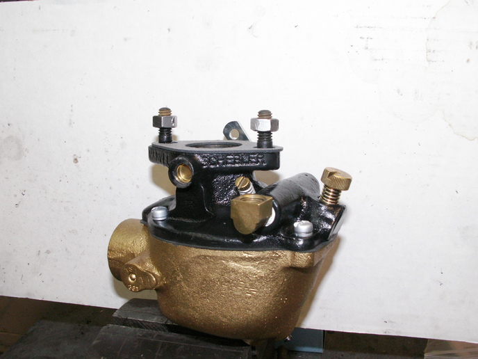

I have made some progress, here are some of the parts that are primed and ready for paint. I'm using Spray Max 2-part epoxy aerosol primer, it's like the 2-part primers you would shoot through a gun, but it's more convenient for me to use the spray cans. It's a bit expensive at around $18 a can, but it dries harder than the hinges of hell, and I know that it's gonna last longer than me. Smile
If you ever wondered what a chrome wheel would look like, this should give you some idea. I sanded one of the wheel centers with 60 grit, and took a pic with it mounted to the axle. You can see I have the tractor "body" primered now, too.
I took the distributor apart and cleaned it up, made sure the advance mechanism was free, installed new points, condenser, and rotor and painted it. This pic shows what the advance mechanism looks like. It was nice and free and the springs looked good, so I didn't have to do anything to it. The two other pics are before/after of the dizzy restore.
Here is the steering box all tore apart. My original plan was to polish the cast aluminum and clear coat it, but I found a shiny aluminum paint that I may use instead. The box is getting new bushings, bearings and seals, and a new steering wheel.

I should have taken some before pictures of the pump to show ya'll how much grunge there was in it. So, imagine 60 years of dirt, old watery oil, and rust chunks laying in there. Here are pics of it all cleaned up. I painted the cover with the aluminum paint mentioned in the previous post to see how it looked. What do ya'll think? Please don't go hating on me because I'm not going to paint the tractor as original. All that gray is just too drab for me. I know the gray is low-maintenance, but I'm going to add some colors to mine.
OK, now it's confession time. Embarassed When I first got the tractor, I went to a web site that had the serial number info to find out when it was built. I read the information incorrectly, and I've thought for almost 2 years that this was a '49.
Got to looking around and found out that I read the wrong column in the chart, and I really have a '51 Fergie. Confused I ain't too smart sometimes.
