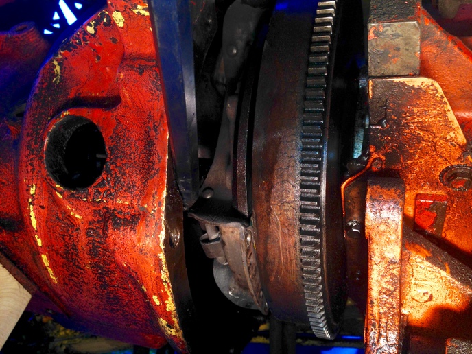

Mine kinda sounded like yours. When you take your
cover off you can get a good look at the ring and
pinion and the pump. This is what I saw in mine.
Ouch! Somebody had been in there before me and
messed up the axle ends, plus a little chippy on the
pinion. Smile Here's hoping yours is better.
It looks like a nice find to me, anyway. I'd love to
have one that matches my 56 F40.
Irv

PostPosted: Mon May 05, 2014 6:36 pm    Post subject: Re: Another Barn Fresh TO 35 - Cracked Lift Housing Reply to specific post Reply with quote
I should have mentioned that this came out of my hi clear 40. Same tranny.
