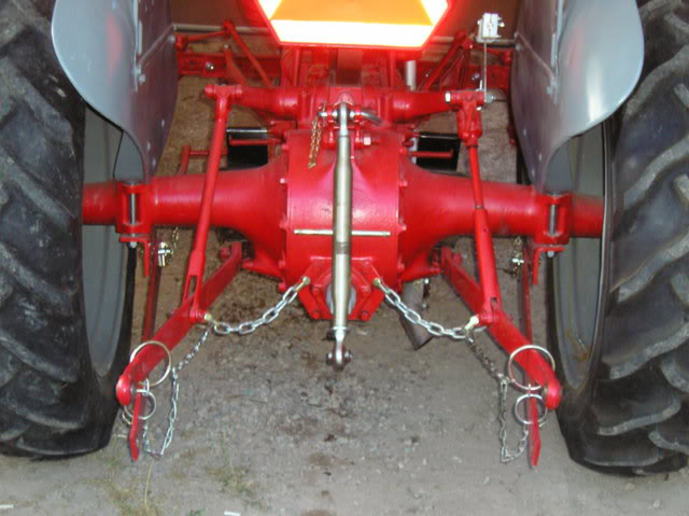

PostPosted: Sun Aug 24, 2014 4:56 pm    Post subject: Re: 9N lift arms bent (replace--new or used?) Reply to specific post Reply with quote
Sparex lift arms are Superior to the other junk out there...
http://v2.us.sparex.com/ItemDetails/ItemDetails.aspx?ItemNumber=60450
While we are at it you need this...
http://www.yesterdaystractors.com/Ford-4000_Drawbar-Check-Chain-Kit_DCK1.html

Hobo,NC
Tractor Guru
Joined: 14 Jun 2007
Posts: 17000
Location: Sanford,NC
Report to Moderator
PostPosted: Mon Aug 25, 2014 6:35 am    Post subject: Re: 9N lift arms bent (replace--new or used?) Reply to specific post Reply with quote
GB's pix make sure you install the brackets at the pto with the chain bolt holes up. Sway bar holder chains are optional...
BTW check out his zaust tip down and out works great...

GB in MT.
Tractor Guru
Joined: 17 Jun 2007
Posts: 6579
Location: Seeley Lake,MT. (home of 'Hermie the 2N')
Report to Moderator
PostPosted: Mon Aug 25, 2014 7:34 am    Post subject: Re: 9N lift arms bent (replace--new or used?) Reply to specific post Reply with quote
Mike Rakow wrote:
(quoted from post at 09:59:20 08/25/14) Hobo:
This is a great reference.....do you happen to know a part # for the exhaust tip...or the inside diameter? Any suggestions where to get one...is this a common automotive part?
Firstly....thanks Hobo, for posting that pic.....I went looking for it in MY files, and couldn't find it....now I got it again!!! Laughing
Mike;
That is a 45deg. slip over that you can buy at any auto parts house (can't remember what ID it was)??
I suggest you measure the end..OD..of your tailpipe then buy accordingly. Attach., so it is through the rear pipe clamp, and use that clamp to tighten it up solid.
Aim the turn-out towards the bottom of the right tire. Exh. will then be caught on the tire tread and moved outward and upward!!!!
Gary
