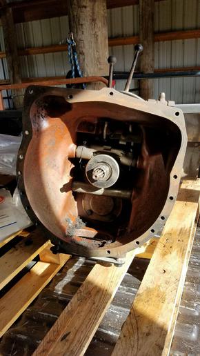

new clutch disc. does anyone know if "F" means the flywheel side? I assume so.

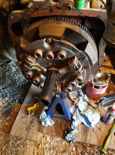

New input (needle) bearing, clutch, pressure plate and rear main installed and buttoned up.

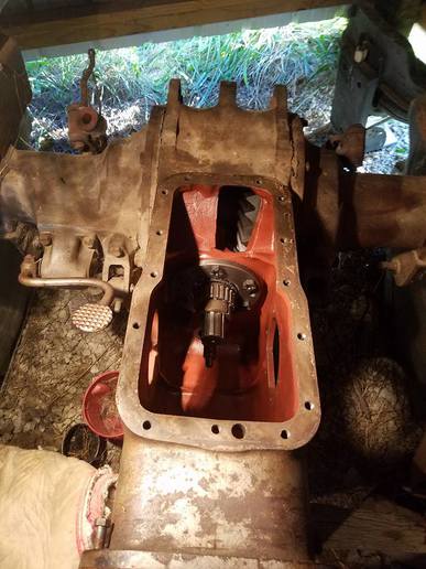

Axle tub cleaned and ready for reassembly.

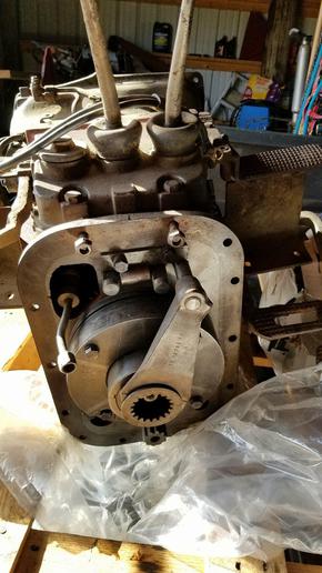

Transmission is rebuilt. I picked it up this morning. The replacement parts list was extensive and the cost was high but it got done faster and more accurately/correctly than i could have done it.
Sometimes you just have to swallow your pride and turn to the pros. Which in this case I did. Pretty remarkable actually. I took the transmission to them in pieces and they completely rebuilt it without hesitation. Most shops I called didnt want to touch it since i took it out, took it apart and it had been sitting in my barn for a year.
Kudos to the Massey Ferguson Dealer in Simpsonville.
