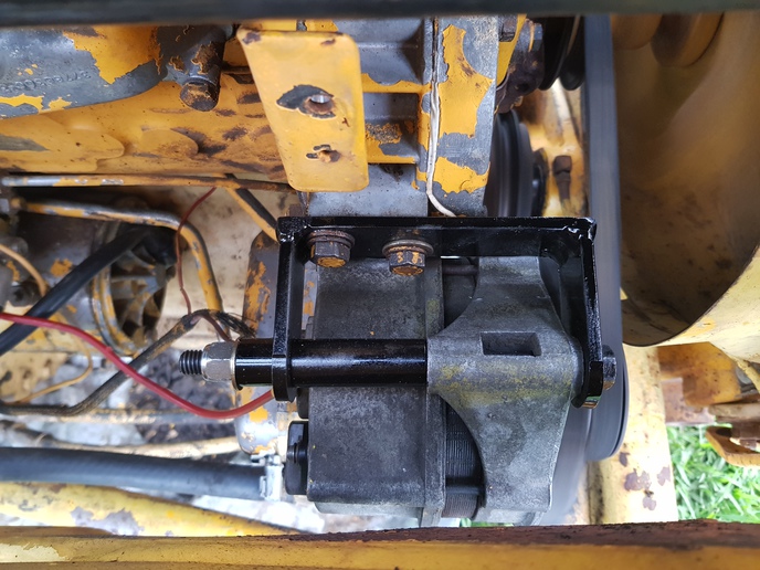

Checked the alternator today and it is a bodged up job, looks to me like the tractor would have had a generator originally.
The steering arm had made contact with the alternator and pushed it out of alignment and looking at the vee belt it had worked like this for some time.
I have seen photos of other MF40 with FEL and they have alternators so it is possible, I guess just I have just got to find a compact design.

PostPosted: Thu Nov 09, 2017 4:48 am    Post subject: Re: MF40 Alternator, Front Crank Seal Reply to specific post Reply with quote
Hi PT
Got a chance to do a bit more today, first job was to confirm where the oil was leaking from.
Drained the remaining engine oil about 1/2 a gallon, refilled with a cheap 15/40 oil, fired the engine up and ran till warmed up, no engine leaks from front seal Very Happy
Found power steer hose/tube to cylinder lh side was cracked, power steer pump US as filled with water and emulsified oil, reprimed put no flow.
The engine is not blowing past the rings near as bad as before and also now starts quicker.
Engine exhaust at idle is blowing a lot of black smoke, and under acceleration as well as at high idle, too much fuel through out the range, not sure what to think here?
No blue or white smoke that makes me think compression is sort of ok and injectors ok maybe, and then the fuel pump is pumping too much fuel?
I used to have to tune the Mini Myners up to pass the gas test in the past and I used to de-rate the injector pumps so they would pass the testing agents test, then as soon as they were out of site. rerate them so we could get the machines to climb out of the coal mine Embarassed they would blow a lot of smoke and oil the scrubber tanks up then.
Anyhow looks like I don't have to strip down to replace the crankshaft front seal at this stage.

PostPosted: Sat Nov 18, 2017 1:24 pm    Post subject: Re: MF40 Alternator, Front Crank Seal Reply to specific post Reply with quote
Hi PTF
With lift arms up out of the way plus the hood off I was able to gain access for a better view of the room to fit the alternator that came with the tractor, made up a new mount and fitted, still a tight fit though.
Had to grind some material off the alternator housing to allow belt to be fitted.
Alternator is charging but not convinced it is doing so correctly, the whole wiring needs a lot of attention.
The spare belt that was tied in place is out of shape and will have to be replaced.
Burgs
