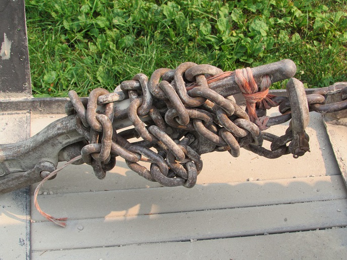

This last photo is how I secure my handles to ensure the binder cannot possibly pop open. When I didn't have any chain to wrap around, I have even used several wraps of duct tape to secure the handle. What do you use?

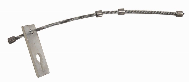

Here in Alberta, the lever style binders are still legal as long as you have a binder lock of some sort securing the handle to the chain so it can't come open on its own.. I use the little cable ones from Dynaline, here's a picture.

I use only US made binders of the style in your pictures. If I have enough chain I wrap them and I always wire them with #9 wire. I have hauled many miles and never had one un snap.

Lyndon - AB. Thanks for posting:

i have both ratchet and over center types, i normally use the ratchet style for over hiway transport, and over center for low speed in town or on a ranch hauling, but there is nothing wrong with using the over center type for hiway hauling, as long as the chains are tight and the binder handle is positively secured, my chains are long enough that i completely wrap the handle with them, ive never had one come open, and i use a 4 foot pipe to tighten the chains
