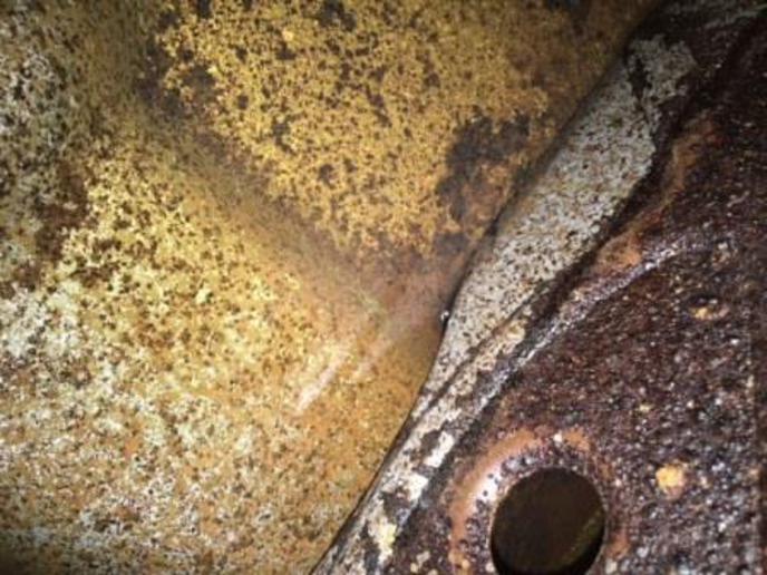

Dan and others on this thread - I've managed to take some decent pictures looking down into the corroded tank from the filler opening. Generally the pictures are looking towards the driver's seat side. The "second tank" is a few inches below the top of the "main tank." Ideas and opinions?
Bill
Fuel tanks usually have baffles in them to reduce sloshing. Some tanks also had a place for a fuel gauge sensor which is usually a round plate with a wire going into it. Is that what you might be seeing?
Dan[img][/img]

I can photo the outside but don't really need to. There is one filler cap through which I took the photos, and no fuel gauge hole. So what we have is an internal tank of some sort that would not fill until you filled up the main tank pretty far. If you filled the main tank to the top, this segregated tank would fill also by spillage though the opening. I've never seen anything like this so I continue to wonder what it's for. It certainly could be a two-gallon reserve that doesn't drain until the gas valve is turned out to full.
I realize some folks don't think so ... but it's hard to see why else you'd weld in a structure like this to the bottom of the tank before welding the top half on. The tank does not leak, but as the pictures show, it's pretty bad on the inside. I'd be willing to do the usual gas tank resto process, except that I don't see how it would work with this unusual section inside. If I go with a repro tank, I can flush this tank and take it apart to see how it is made.

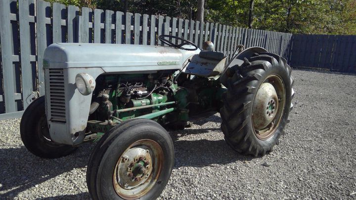

Photo of the actual tractor below.

To be honest I do not believe that tank needs anything more than a good cleaning. I have seen some that were much much worse and the owner just cleaned it and rinsed it out good and put it back on. If you want to spend more money order a new tank and hope it will fit as well as the original one did.
