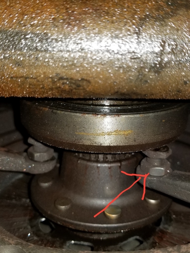

I need to find the technical name for the adjustable bolts, that press on the throw out bearing. There are 3 of them, 1 on each arm. I want to search the web to see if I can buy replacements. My tractor is a TAFE 35di, 1996. John Deere D was kind enough to help me diagnose and find the reason my PTO quit working. The drive hub had sneered off of the PTO disk. The factory had left the 3 slave bolts in the pressure plate after install. The main disc and PTO disc still look hardly worn and the false fly wheels are not burned or worn. I want to replace the disc, throw out bearing and pilot bearing. To replace the whole pressure plate assembly is almost $400 compared to less than $100. I will try to post picture of what I need. Thanks to everyone for a great forum.

A GOOGLE search for "clutch finger bolts" turned up over 2,000,000 possibilites.
I presume they are metric?
There's a "clutch and brake and industrial friction" place a couple hours from me and I've gotten America clutch finger bolts from them, but I've never asked about metric.
Any place like that near you/in the Yellow Pages?

Thank you Bob for the reply. I will do a little searching and see if I can find similar place near me. I'm about 20 miles west of Augusta Ga, in McCormick SC. I will remove one the bolts and see if it's metric or standard. If I can't find a place near me, would you be willing to share the phone # of the place up your way. Maybe they will ship if they have what I need.

Looks like the common MF clutch lever bolt the 65 and newer tractors used..

I measured one of them and not counting the bolt head, (they are worn down), they are 13/16 long and 3/8 in diameter. The thread count is 24 TPI, standard US thread pitch.

Info as per MF service Manual & Parts Book:
