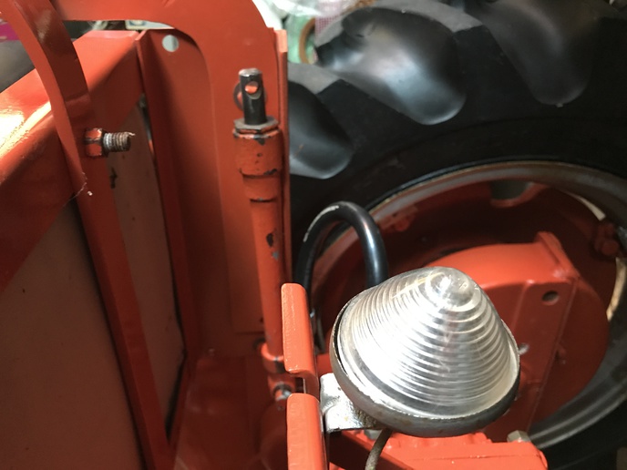

Hey Folks,
Been restoring my Grandpa's 1951 B. This was the tail light on it. I know that I need to attach under the seat frame so I'll do that, but is this light original? I've never seen another one, and if so does anyone know where to find one?
Thanks!

No!

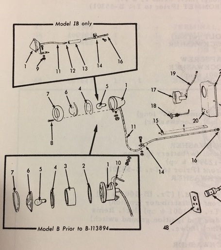

Here were the light offerings. I'll post back with a photo of an original and the modern reproduction this evening.

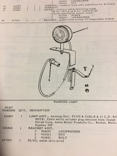

Here is another light the B used just for completeness. I have never actually seen one, or the aux socket installed. Would like to. It's looks very similar to the stalk lights available nowadays. I included the text above where it talks about the serial numbers where the aux lighting circuit started to be available.

Dick L is correct in saying that the white light you have pictured is incorrect. The bullet shaped red ones are also incorrect for a B.
The correct one has an almost flat clear lens, with the outer circumference having a red light. The red one is the hard part to find. I have several of the clear lens somewhere around here, packed them up just before the flood and haven't found them since.

I have the same light as Seale12 on my 51 B. I am the third owner and I believe this is correct. Mine was in great shape. The red lens is actually Red to orange to yellow. Quite nice. Cool tractors. There is also mounting holes on the left fender for an auxiliary light which I do not have.
