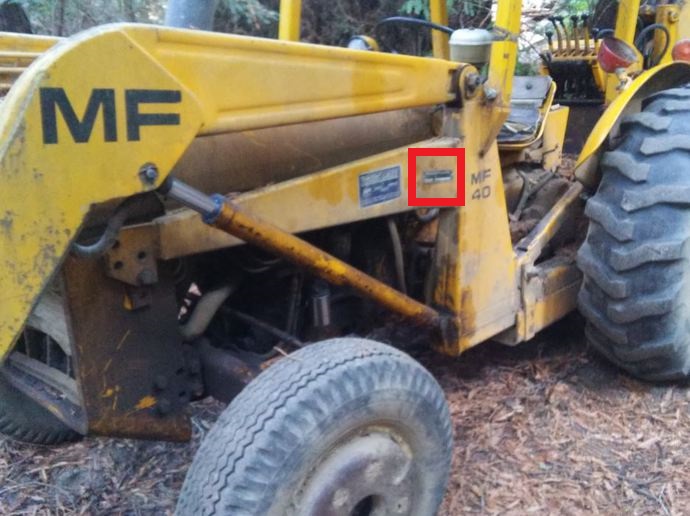

I have a mf202 loader backhoe and the loader valve spools are leaking.They seem to have detents in both positions,my question is can i just pull out the spools or or is there going to be pieces flying out.Thanks for any help.

What is the model number of the loader, if its a MF loader there should be a tag on it (see red box in picture).

ptfarmer thanks for reply the tag is missing but it looks exactly like the picture the valve has AICO on it.I will send photo when i get to machine.Thanks

pt farmer here are the photos of the loader any help appreciated thanks [/img]

Looks like a MF 102 loader to me.
This valve would work, but you'd have to plumb it in through the original return port, make a new flange for the return in original location, or have a new return bung welded into the loader frame:

It is Davis model 99 loader (MF bought out Davis), if you are in North America toy can log in as guest user on AGCO's parts website. Click om the view books button, enter the model number, and select MF from the drop down menu. Look for Davis 99 loader, the control valve you have is on page 16.

It's not a MF/Davis 99.
The 99 had only one curl/dump cylinder and in stock form did not have down pressure on the (SA) lift cylinders, but the curl/dump cylinder is DA.
The 101 also had one curl/dump cylinder (DA), but the lift arms had down pressure (DA) cylinders.
The 102 has DA cylinders for lift arms, and two DA cylinders curl/dump.

Just make sure that the 99 uses the same spool valves as your loader if you're using that parts breakdown. As mentioned in the link above, 99s didn't have down pressure on the two loader lift cylinders. There may be differences in the spool valve, ptfarmer might know.
Also, rereading my posts above, I did not mean to come off as snotty as they kinda read! I was in a rush when I posted so I was a bit more curt than usual. Hopefully yours can be rebuilt. If not, the valves I posted earlier will get you back up and running AND add the option for float.
One last difference besides steel thickness on the 99 vs 101/102 loaders is that the 99 was not set up for use with a backhoe. Your loader appears to be from your pics, so I'm sticking with MF 102 is your loader.
