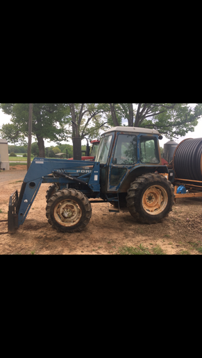

I own a 1983 Ford 5610 with Cab, MWFD, and front loader. Can anyone help me identify which power steering pump I need? Unfortunately there were not many English style tractors like this here in the US in the early 80s so I’m having difficulty identifying the correct pump. Earlier this year the housing of the steering sector burst a piece out of it so I needed to replace it. The gentlemen helping me with the parts said I had the incorrect pump installed which provided either 2500 or 3500 psi (this led to sector damage)but he said I actually needed the one providing about 1100 psi. Problem is that now the steering is fairly hard to use so I’m wondering if they actually gave me the wrong pump or if I have another issue. I have attached pictures of the tractor, tractor serial number and part numbers of the steering sector and new pump. I think I really need someone that knows the English tractors to get to the bottom of this. Can anyone help me? So far all the dealers have been non-helpful to me. Really hope we can figure this out as I love this tractor. Thank you

PostPosted: Tue Nov 21, 2017 12:25 pm    Post subject: Re: Need help identifying steering pump Ford 5610 Reply to specific post Reply with quote
Pump # E6NN3K514EA was changed to E6NN3K514EA99M and superseded to 87759440
It shows to be a good number for a ps pump on a 5600 without cab and is rated for 1100 psi.
The correct pump for a 5610 is E6NN3K514PA99M which is superseded to 82858430 but no psi rating is listed.
The highest psi pump I could find was 1600 psi for a backhoe with hydrostatic steering, the pump for my 4500 industrial makes 1250 psi.
If your old pump was making 2500-3000psi someone shimmed the heck out of it.
The added weight of the cab, MFWD and loader puts a lot of stress on the older style steering sectors and is likely part of the reason Ford changed them to hydrostatic steering in 85.
You can get the correct pump or see if someone can tell you what the psi is for the correct pump, you could have the pump you have shimmed for more pressure but I wouldn't get to crazy or you'll be replacing the sector again.

PostPosted: Tue Nov 21, 2017 3:33 pm    Post subject: Re: Need help identifying steering pump Ford 5610 Reply to specific post Reply with quote
Of all the pumps listed E6NN3K514PA99M is the only one listed for the early 81 to MAR-85 5610.
Farther search shows it's the only pump presently listed for 81-88 5610's.
Basically you need more pressure in order to steer with the added weight, but your limited to the old style steering sectors ability to handle pressure needed to steer with that weight plus the stress subjected to the sector.
Even with a empty loader you should be able to turn the wheels sitting still on firm ground, with a full bucket or round bale on the loader or in soft ground not likely, but steering should be fairly easy when moving.
The hydrostatic steering on my 6610 cab 2WD with a round bale on the loader in soft ground will stall at times when sitting still, but goes back to steering fine as soon as the tractor starts moving.

PostPosted: Wed Dec 20, 2017 8:11 pm    Post subject: Re: Need help identifying steering pump Ford 5610 Reply to specific post Reply with quote
I went to eBay and looked at those pumps, apparently I have made a mistake.
E6NN3K514PA is for models with hydrostatic steering and does not have a pressure relief valve.
DO NOT buy one of those pumps!
That's most likely what was put on before that caused the sector failure.
Back to top
View user's profile
Destroked 450
Tractor Expert
Joined: 31 Mar 2016
Posts: 2647
Location: Harned, Ky.
Report to Moderator
PostPosted: Wed Dec 20, 2017 8:37 pm    Post subject: Re: Need help identifying steering pump Ford 5610 Reply to specific post Reply with quote
Ok I've rechecked info again and it appears there's some conflicting info on this pump.
They list some pumps with part number E6NN3K514PA having a pressure relief valve and others not having a relief valve.
The ones without a pressure relief valve are for 85 and newer models with hydrostatic steering.
Make sure the one you purchase has a relief valve for your older sector style steering.
Or you could take the one you have to a pump shop and have the relief valve shimmed to not over 1300 psi.
