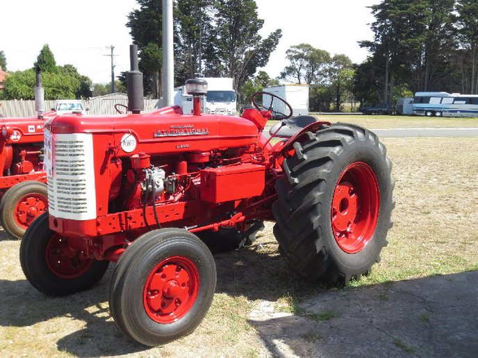

PostPosted: Sun Nov 26, 2017 4:11 pm    Post subject: Re: W6 vs W4 Reply to specific post Reply with quote
Never driven a W4 or a W6, but the first tractor I ever drove was an AW-7 Diesel raking hay with a GL-100 rake under my Dad's watchful eye. That was the beginning of my love for IH products. Dad eventually sold the AW-7; I would love to buy it back or get hold of another one. Magnificent tractor! Photograph is of an AW-7 Diesel at an IH Club Rallly in Geelong.
SadFarmall
