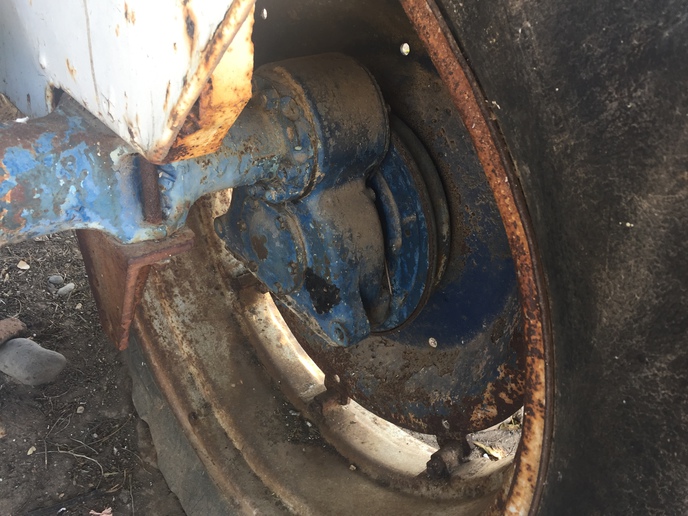

PostPosted: Wed Dec 06, 2017 5:45 am    Post subject: Re: Need help with ID of my 4 cyl diesel Ford Reply to specific post Reply with quote
ok I have some more. Thanks [img]http://forums.yesterdaystractors.com/photos/7187.jpg[/img] [img]http://forums.yesterdaystractors.com/photos/7188.jpg[/img] [img]http://forums.yesterdaystractors.com/photos/7190.jpg[/img] [img]http://forums.yesterdaystractors.com/photos/7191.jpg[/img]

PostPosted: Wed Dec 06, 2017 6:12 am    Post subject: Re: Need help with ID of my 4 cyl diesel Ford Reply to specific post Reply with quote
Destroked 450 wrote:
(quoted from post at 23:45:15 12/05/17)
roll crop
You've used this term several times. I think you mean "row crop"
And yes, the picture of the rear end definitely is that of a row crop 4000. Likely the transmission has been swapped in out of an all purpose.

PostPosted: Wed Dec 06, 2017 7:46 am    Post subject: Re: Need help with ID of my 4 cyl diesel Ford Reply to specific post Reply with quote
I'm not sure why your pictures didn't load when you tried to post them. I've posted them below. It's best to put each image with it "img" and "/img" tags on a separate line, otherwise if they do display the web page will load with them all next to each other and we will have to scroll our browser left to right to see them all.

PostPosted: Wed Dec 06, 2017 8:07 am    Post subject: Re: Need help with ID of my 4 cyl diesel Ford Reply to specific post Reply with quote
For sure a row crop axle.
Close up pics are ok but how bout backing off and getting pics of the hole tractor from both sides.

Carle wrote:
(quoted from post at 09:48:14 12/06/17) OK Why do you think transmission has been swapped out?
Oops forgot to answer this one. The reason I think the transmission has been swapped is that you have a partial all purpose or utility model number stamped on the transmission and your tractor is very obviously (the rear end and drop box photos) a row crop version.
