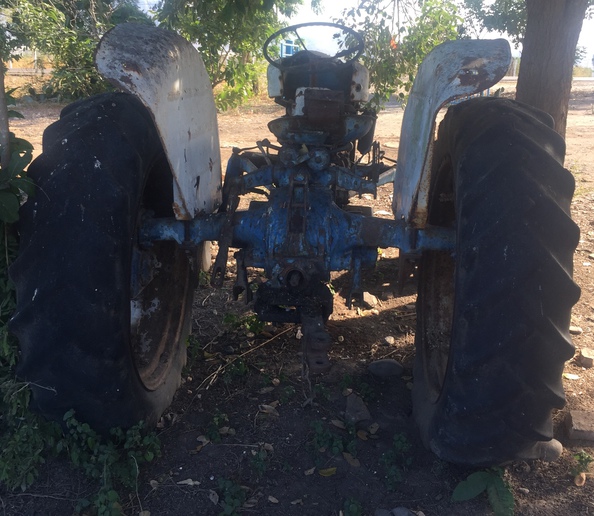

I have four more photos I shall try and share. I jacked up rear wheels and there are problems with the drop boxes on both sides. Wouldn’t surprise me if that was the reason it was parked all those years ago.
[img]http://forums.yesterdaystractors.com/photos/7314.jpg[/img] [img]http://forums.yesterdaystractors.com/photos/7315.jpg[/img] [img]http://forums.yesterdaystractors.com/photos/7316.jpg[/img] [img]http://forums.yesterdaystractors.com/photos/7317.jpg[/img]

Here's your pictures

Definitely ag style radius rod front end but with taller than normal spindles, and a row crop rear axle.
When you need parts for the rear axle and 3 point lift linkage look for 901 series or 4 cylinder 4000 row crop parts. When you need parts for anything else except the front spindles look for 801 or 4 cylinder 4000 series parts. I can't find those front spindles anywhere in the parts diagrams unless they used high clearance row crop axle ends on a standard ag chassis axle center.

It is apparently a legitimate high crop even though not all the parts are original.

I do not see a "high crop" model listed in the parts drawings. I do see a "High Clearance Row Crop" model listed and it has the regular row crop rear axle, and the front axle setup from a wide front row crop, but with taller spindles. That tractor has a radius rod front axle like a general purpose ag chassis model, not a wide front row crop front axle, but it has the taller spindles like a row crop.
what is the nature of these problems?

Like Dean I could only find the high clearance (high crop) axles and spindles in a row crop model listing.
With all of the modifications done to the hood, dash support and other components, though I hate to say it, I can only surmise that this tractor is a home made mutt.
I believe this tractor may have left the factory as a high clearance row crop model, but at some point the row crop front was wrecked or removed for some reason and a attempt was made to install a utility front support and steering.
Before I did much of anything to that tractor I'd check to see if the drive train was of usable condition. To me it would take a lot of time and money to get it back to a usable tractor, unless one has a junk row crop to rob the needed parts from.
That said, I don't think I'd junk it out, high clearance row crops are a bit rare.
With the last number in the model number possibly being a D instead of a 0.
D would be the suffix letter for a diesel engine which the tractor has.
4 is the suffix number for a high clearance wide front model.
But did Ford ever add 2 suffix numbers-letters to indicate a tractor had more than one option.
If not how can one verify a tractor like this is a diesel high clearance model.

I believe that they did use multiple suffixes if the tractor had more than one option that would call for a suffix.
The model number that's on the transmission claims it is a general purpose ag chassis, not a row crop at all and a high clearance row crop would have a row crop model number with the 4 as a suffix.
But that number is on the transmission so the transmission was not in the same tractor that the rear axle was when they left the factory. As I said in an earlier post, that's all you can really say without knowing the date codes on all of the major components to get a "vote" on what the majority of the tractor is.

Rear drop boxes. When jacked up the wheel turn backwards fine. One side goes forward but grudgingly. The other side will not go forward. I am guessing the brake pads are binding.
Transmission seems fine. Shifts in and out of gears.
