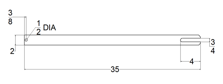

I will provide the dimensions of item #19 this afternoon.

Attached are the dimensions for my JD158 loader.
It's ether 1/2" or 5/8" thick

IIRC this bar isn't straight but has some angles in the narrower width areas at each end to account for differences in width of mounting frame & mast.
