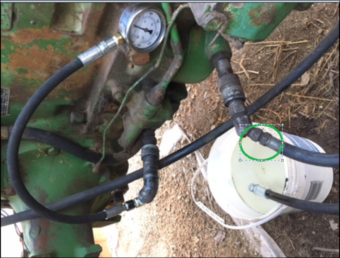

PostPosted: Thu Nov 30, 2017 5:31 am    Post subject: Re: 1020 hydraulic issues Reply to specific post Reply with quote
Thanks everyone. Ok let me answer a few questions.
late model serial # post 45199. no seperate power steering pump. Just pulled the whole thing apart so I'm pretty familiar with it. I spent a lot of time on here researching before I tackled that project.
JD 143 loader (not sure open or closed)
In the picture you can see the plumbing of the priority valve. loader line removed and gauge installed at rear of valve. Loader line is in the bucket. Not sure if this is an accurate reading with the loader line open?? 3000 PSI and seemed to be climbing. I did it fast, because I noticed it was filling the bucket, but I may have cracked the valve and the loader probably fell some filling the bucket?? I was worried the 3000 psi. gauge might pop.
The second pic is the pump housing showing the port at top center which i tapped to get the 1000/1100 reading. which is what the IT book said to do.
8 piston non splined pump. I rebuilt the original pump with all new seals (put it back together with a slightly worn shaft and it leaked like a sieve). replaced the pump with a reman but never checked the pump pressure.
As I said, after making the first check on the pump housing, I cranked up the stroke valve maybe 1.5 turns. How much difference in pressure would a turn or half turn make?
I will turn this back down. My plan right now is to rehook up the loader and put a quick coupler on the gauge. I will then check the pressure with the loader disconnected and see if steering improves. Lastly I will port the return line to the fill hole and check for fluid seepage with the loader valve in neutral.
Internal leaks are totally possible. When we removed the housing with the planetary for the high/low, we found the housing was also cracked and damaged internally. The replacement housing should have resolved this but there could be other problems in the transmission case. We originally split the tractor to check the low pressure trans pump, however that appeared to be in good working order with no signs of wear. Unfortunately, we put it back together with the rear end of the unknown parts tractor so I do not know the exact status of the pump currently in the machine. After this fix the hydraulics worked better for a little while ( more down pressure) but then the steering got worse.
I pulled the steering because someone suggested bad seals in the valve might be causing the problems. (steering locks and worse pulls to right.)
Mad However this made little difference.
The loader valve makes a lot of sense because it is the only variable that has not changed. Even the priority valve was switched out when the new rear end was put on.
Sorry the pics are turned sideways not sure why they uploaded that way, they are right on my computer??

To determine if FEL control valve is OC or CC reconnect pressure hose then disconnect hyd fitting(green circle) & with both levers on FEL valve in neutral start engine & no oil should exit open hose.

PostPosted: Thu Nov 30, 2017 6:53 am    Post subject: Re: 1020 hydraulic issues Reply to specific post Reply with quote
If the hose in the white bucket is coming out of the filter housing , through loader valve and pumping oil into into bucket this will rob return circuit of oil needed to
supply main front pump and reduce out put . It can be plugged for testing purposes .

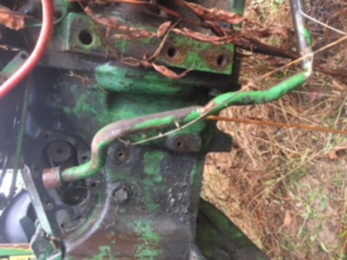

PostPosted: Thu Nov 30, 2017 9:59 am    Post subject: Re: 1020 hydraulic issues Reply to specific post Reply with quote
There is a second (return?) hose going to a port right near the fill hole on the back of the transmission. If I remember right it comes off the left side of the loader valve just above the return going to the filter housing. Is that a filter bypass? If so what do I do with that hose to check it?

PostPosted: Thu Nov 30, 2017 11:32 am    Post subject: Re: 1020 hydraulic issues Reply to specific post Reply with quote
Correct ""closed center hyd hose attachment"" for FEL control valve to tractor only requires 2(two) hoses which are pressure & return. If your tractor loader valve has 3(three) hoses attached from tractor to the control valve it attached incorrectly. Sounds as if someone installed an open-center controlled loader on a closed center tractor. See photo below that shows open-center system.

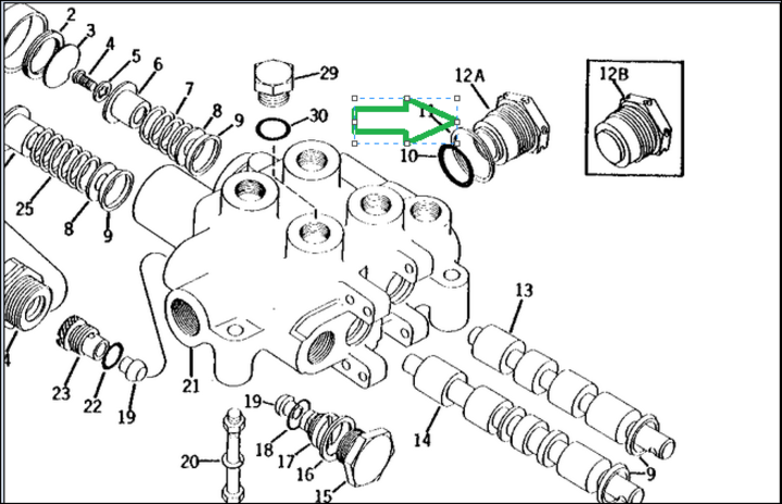

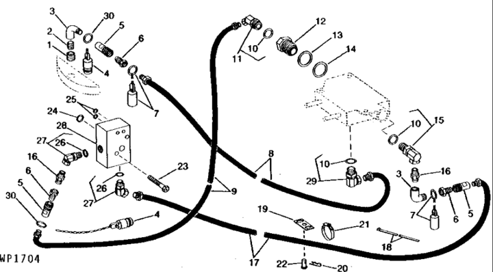

So if the loader is open center, how would I check to see if the valve is operating properly? If my understanding is correct, oil is always flowing through the third line back to the transmission?
I'm going to disconnect the pressure line today and see if that helps the steering, ect.
Also someone suggested disconnecting the return line to the filter to check for leakage in neutral. But not sure if that is possible with open center?
If valve is bad... Can I replace it with a closed center valve and do away with the open center hose all together? If so does anyone have a suggestion on a good valve for an old used tractor that won't break the bank?
Apparently there were at least three different valves used on the loader, not really 100% sure which one I have.

PostPosted: Fri Dec 01, 2017 4:36 am    Post subject: Re: 1020 hydraulic issues Reply to specific post Reply with quote
mb1020
You can disconnect return hose on open or closed center frt end loader valve then start engine with no ill affects to determine if valve is OC or CC. As I previously stated there's no good reason for FEL valve to have 2(two) return oil hoses on a JD 1020. If your tractor has 2 return hoses then aim both hoses with open ends in a bucket & if oil comes out of either or both hoses with levers in neutral with engine running you have located part of your tractors hyd problems. If oil comes out of return hose as I think it will you need to install a CC plug(green arrow) with correct seal(key 10).

PostPosted: Fri Dec 01, 2017 7:09 am    Post subject: Re: 1020 hydraulic issues Reply to specific post Reply with quote
So I turned down the pressure a bit. Haven't rechecked it to see where it's at.
When disconnected, oil flows out the hose coming from the side port of the valve, which is plumbed to the filter housing, no oil flows from the other hose unless the valve is cracked.
However, the oil slowed to almost a stop after a few seconds. I was getting a bit low on oil so I turned it off. But I thought it might also be starving for oil. The 1st pic is of the steel supply hoses next to the brake. They were pretty crushed when I got the tractor, but the the hydraulics seemed to work so I left them. I have a replacement for the pipe going to the oil cooler, but not the one going to the pump. It was damaged in the tractor split operation. 2nd pic. Is it possible to replace these lines with rubber? They have a weird fitting on the end that slides in the case.
Could this cause the problems?
Also I tried the steering with the loader disconnected. There was minor improvement but nothing to really brag about.

PostPosted: Fri Dec 01, 2017 7:53 am    Post subject: Re: 1020 hydraulic issues Reply to specific post Reply with quote
Mark If you are using the line in the picture it would probably be a good idea to replace it or repair it . I have not tryed to replace it with a rubber hose, it mite
be possible . I was always told repair all known problems first . Did you look at suction screen , and replace hyd filter while you were doing trans. swap .You know JDEM
had a great way to check for internal problems with high pressure side of hyd. system.
