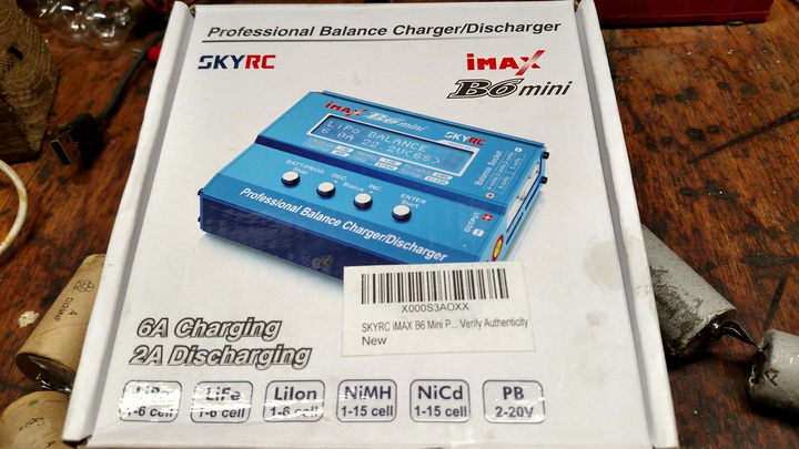

Here is what will do the job. You can get one with its own power supply. Mine is powered by my power supply. Go to Skyrc for the real thing. Plenty of knock off copies out there. Read the box for all the batteries types it can charge,
Guido.

What are you using for a power supply.. specs show input 11 to 18 v ? DC ? If DC will small 12VDC battery charger work? Thanks

A 12volt charger should work. My power source is a 15V 3.5 amp capacity. A fully charged battery should work too. The charger will show low input voltage if your source is too low,

I ordered a small charger intended for r/c applications... A little more than the battery requires and should be an interesting experiment.
