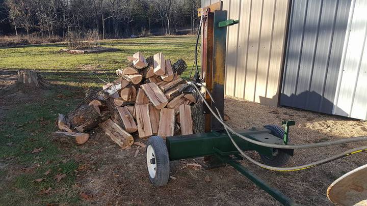

Got my remote hooked up on the 8n so I could run the splitter I built. This was the first wood I split with it. Worked great.

Are you hooked up to a front pump?

(quoted from post at 19:53:18 12/01/17) Are you hooked up to a front pump?
Yes sir

Nice kev, could you show some pics of the pump setup. I've never seen one.

allenlane wrote:
(quoted from post at 06:36:41 12/02/17) Nice kev, could you show some pics of the pump setup. I've never seen one.
The splitter started off as a 3 point splitter and I was on my way to turning it in to a stand alone. I found a Paulson front end loader for my tractor and needed to install a front pump to run it more efficiently than the 3 point lever. So I figured why have to buy 2 pumps and have a engine setting around several months out of the year not being ran. So I put a big enough front pump on to run the splitter. And I gain a set of remotes if I ever need to unfold a hay take or anything else than has hydraulics.

That chain coupler worked out nicely. I'm confused by the remote valve on the fender - is that the control valve for the cylinder on the log splitter cylinder or some sort of selector valve for the quick connects????
TOH

the valve on the fender is what I control the remotes with. The splitter has its own valve

I'm still confused. How do you use that valve to supply the valve on the log splitter? If it is a single spool control valve which is what it looks like I would expect it to be spring return to center...
TOH
TOH
It is spring return so i do have to manually hold it in with a bungee cord.
