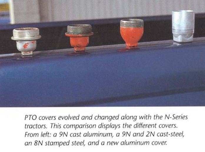

Also, what does the OEM PTO cap cover look like. I've seen several designs but am not sure what is correct for my model.
Most likely yours would be 2nd from the left.
