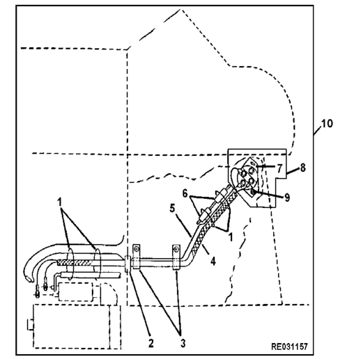

1970 gas 3020. Last summer began intermitent problem of not cranking when key turned to start. Sometimes clicking, sometimes nothing. Cranked and started right up with srew driver accross two lugs on the solenoid on top of the starter. Has become more frequent problem. Acknowledge from historic threads it may variety of causes but am thinking to replace solenoid, or what I think to be the solenoid, which I understood to be the small cylindrical arrangemnet on top of the starter. However, as I study the project it appears not to be detachable but instead, part of the starter. Am I offbase in my thinking?
If the starter must come off, there appears to be two easily accessed bolts on the outside and at least one in the back that is not easy to get at. Is that correct and can the one in back be reached with a socket and extensions? Other issues that I haven't properly considered? Thanks.

Assuming the OEM type Delco 35MT starter, a new starter-mounted solenoid is $15-$20 and pretty easy to check and/or replace. Delco solenoid # 1115510.
These solenoids draw a lot of current and sometimes will work when jumping with a screw-driver and not work with a key-switch. Many tractors got an extra starter-relay added to enable more power to get to the solenoid and take the load off the key switch. So besides the solenoid on the starter, you might have a relay in the system too. New relay is only around $8-$10.
Check voltage at the relay when trying to crank. If 9-10 volts and not engaging, the solenoid is bad. If below 9 volts, you have a wiring issue, bad relay, bad ignition switch, etc.

Is the starter relay you reference the one in the picture? If so is it the device located in a little box like enclosure directly above the back end of the starter?
