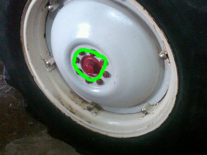

The NAA/Jubilee will have a big nut in the center of the rear
axle hub like the 8N does. A 640 will not have that nut.
Back to top
