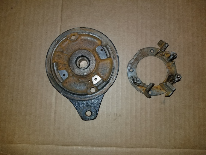

PostPosted: Mon Mar 12, 2018 5:22 am    Post subject: Re: Farmall C Electrical Drawing Reply to specific post Reply with quote
Well, over the holidays, I determined that the wiring on this old tractor was in really bad shape. So, this past weekend, I drove to Maryland again and my Dad and I replaced the entire wiring harness and the battery. We used a very nice replacement harness provided by Porch Electric. It amazes me how easily this old tractor starts!
Anyway, when the tractor is running, the ammeter is showing discharge. I've double checked all the wiring and everything seems to be in order. I've opened the voltage regulator, which my Dad replaced about 2 years ago. It looks new inside. I also opened the band cover on the generator. There was a good bit of rust in there, so I pulled the brushes, cleaned everything up really good and replaced. The armature had a thin layer of corrosion on it before the cleaning, like the brushes were not making contact. After cleaning the armature shined right up in about 5 minutes of run time. This generator was rebuilt by a local shop when the regulator was replaced.
I also performed the motor test on the generator. Here's where I need some help. The generator spins during the motor test, if you give the pulley a little nudge. When I disconnect the ground from the F terminal, I get mixed results. Sometimes there seems to be a slight increase in speed, other times not so much. It never "runs away". Should the generator spin without help and should I see a drastic increase in speed when disconnecting the F terminal ground?
Also, I've read a little about the use of digital voltmeters. All I have is a digital voltmeter. Should I be able to read the generators voltage at the battery terminals with a digital voltmeter? It's a Fluke 77. I've read that you need an analog meter.
At last, looking into the generator from the brush area, I see a complete layer of thin rust. It looks like water was setting in there at some point. Is there anything in there that would benefit from a remove and clean?
Thanks in advance for any help!

PostPosted: Wed Mar 14, 2018 8:00 am    Post subject: Re: Farmall C Electrical Drawing Reply to specific post Reply with quote
For the benefit of those that may run across this in the future:
I decided to go ahead with a complete dismantling of the generator. I loosened the two long through bolts while the generator was still on the tractor. This made it an easy job removing these on the bench. The generator end with the pulley on it pulls out of the generator body easily with a few light taps. No need to remove the pulley. The generator end and the generator body are aligned with a pin, so replacement is foolproof.
Next, the other generator end was easily removed from the body, again with some light tapping. This removes the brushes and all the associated springs and mechanisms. Again, alignment is achieved with a pin. I removed all the brushes and wire brushed this assembly with attention to detail. The little areas that hold the brushes in place seemed clean, but looking closer revealed areas of caked-on brush dust. These areas undoubtedly interfered with movement of the brushes. The brush holders and springs were not moving very freely either. Again, attention to detail with a smaller wire brush cleaned these up very nicely. I was thinking that putting even a very small amount of lubricant would just serve to collect brush dust, but I applied a very small amount of 3 in 1 oil anyway, to all the springs. They started to work like they should, very smooth.
For the armature end, I left the pulley attached and just worked on the armature as it is removed from the generator body. I wire brushed all the light rust from the armature and shined up the area where the brushes ride with some light wire brushing. I also used a wire brush to remove loose rust from the generator end. I was concerned that this loose rust might come lose and find its way to a brush and get in the way there.
For the generator body, I brushed the fields the best I could and used a screwdriver to scrap away any loose rust from the areas where the fields meet the generator body. I also used my multimeter to check continuity between the wire coming from the field and the outside posts. I didn't mess with the field wires much because they looked a little fragile. I may replace the fields next time up there.
My Dad said that he remembered a time when the tractor got rained on. The next time he started it, water came out of the generator. I'm sure this was the starting point of all these problems. Of course, after the fact, it all makes sense!
