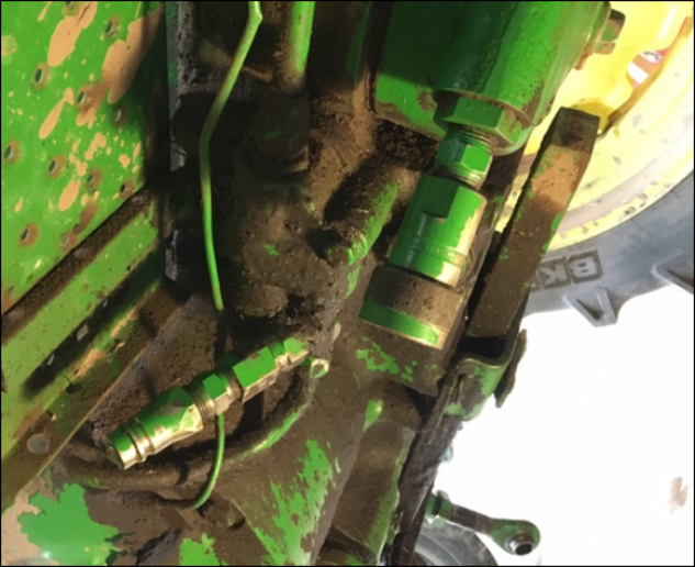

IMHO if this photo which firhead posted earlier of is of firhead's tractor all he needs to do is attach pressure(in) hose of log splitter valve to "male tip" in photo & return(out) hose of splitter valve to "female breakaway coupler" then start engine & split wood IE nothing more to buy

Thanks for the pic. Yes that will do the job perfectly! I did the same thing to my BIL's tractor after is cousin

OK - this is interesting. I'm up and splitting out of one of the remotes - if I keep my rpm up around 1500, nothing
shudders, cylinder cycles, nothing seems weird. But you advise to make things more efficient and/or less strain on the
system, I hook up splitter valve in/outs as you advised, into the old loader ports down by the filter cover. What am I
bypassing (or adding) to the circuit to make this work better? I see references to a 'front pump'. This implies some other
pump. Just need some more basics to get this in my head. Is there online schematics of this stuff available that anyone
could suggest? Thanks one and all for your ongoing help.

IMHO Simple answer is if splitter operates to your satisfaction with no shudder or delay then I'll suggest to leave it attached to breakaway coupler the way it is.
With factory scv without return oil attached to ported filter cover as shown by photo Bob posted return oil normally gets back to hyd reservoir by being dumped in the side of rockshaft(3 pt) housing. By routing return hyd oil to hyd ported filter cover oil gets sent to frt pump at a higher rate than if simply dumped back to reservoir. Trans pump oils trans,operates hyd pto & hyd hi-lo then supplies excess oil to frt hyd pump. Frt hyd pump can't suck oil but must have oil supplied to it.
