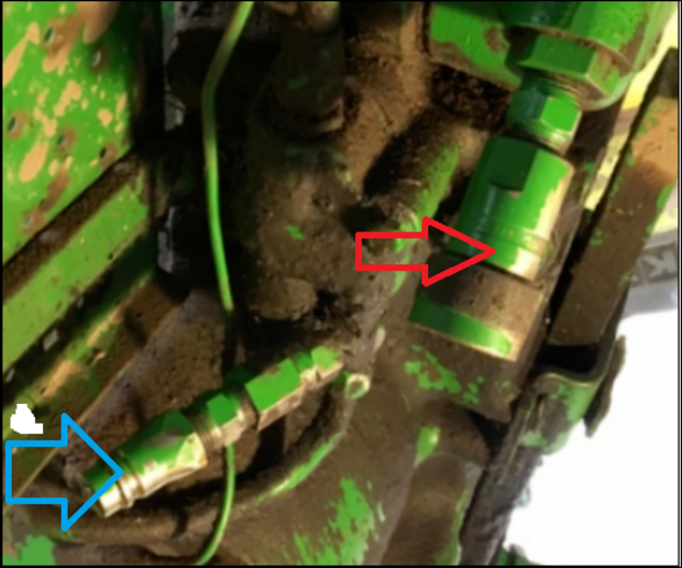

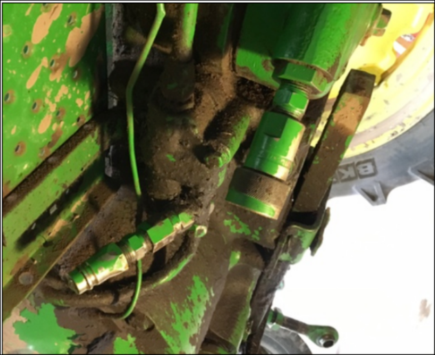

jr1983 wrote:
(quoted from post at 21:33:42 01/01/1Cool
Can you put a power beyond on his unit?
This photo that firhead posted of the hyd fittings on his tractor is about as close to "power beyond" as I've ever seen installed on a JD utility tractor of this era IE his tractor already has PBY installed on it.
Back to top
View user's profile
jr1983
Long Time User
Joined: 27 Apr 2014
Posts: 1160
Location: Illinois
Report to Moderator
PostPosted: Tue Jan 02, 2018 5:38 am    Post subject: Re: splitter hydraulics once more Reply to specific post Reply with quote
OK I had it backwards. I was thinking you were picturing the return not the supply. Sorry for that. Also I would absolutely hook up a splitter in this manner. Never seen anything good come of tying a remote open in the long term though I'm sure it would split wood as is.

Tx Jim
Tractor Guru
Joined: 14 Feb 1999
Posts: 25654
Location: N Central Texas
Report to Moderator
PostPosted: Tue Jan 02, 2018 5:54 am    Post subject: Re: splitter hydraulics once more Reply to specific post Reply with quote
For clarification blue arrow is for pressure connection & red arrow is for return connection

Tx Jim
Tractor Guru
Joined: 14 Feb 1999
Posts: 25654
Report to Moderator
PostPosted: Wed Jan 03, 2018 11:27 am    Post subject: Re: splitter hydraulics once more Reply to specific post Reply with quote
Glen D Anderson
firhead doesn't need a complicated oil schematic for his tractor. All he needs to do is attach pressure(in) hose of ""closed center log splitter valve"" to male hyd fitting(blue arrow)then attach return hose(out) to female breakaway coupler(red arrow) of photo I posted then he has splitter valve attached as best can be accomplished.
