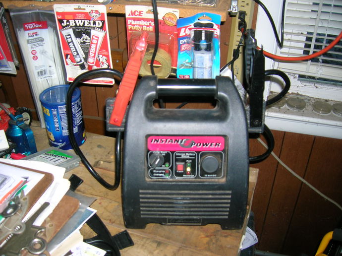

do you one of these gizmos? i use mine alot to start dead tractors.

PostPosted: Sat Dec 30, 2017 5:39 am    Post subject: Re: Starter trouble to30 Reply to specific post Reply with quote
as someone once told me the starter does not care. just don't spin it too long.
Back to top
View user's profile
steve19438
Tractor Guru
Joined: 30 May 2011
Posts: 3775
Location: harleysville pa
Report to Moderator
PostPosted: Sat Dec 30, 2017 5:41 am    Post subject: Re: Starter trouble to30 Reply to specific post Reply with quote
when i use my battery pack and after connecting to starter and then connecting to a ground (usually gearshift lever) the battery pack will hum when i get a good connection. then i flip the switch on the pack and away we go.
