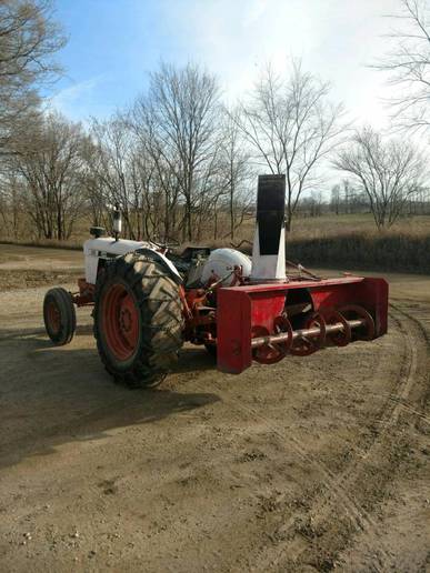

Here are some photos..

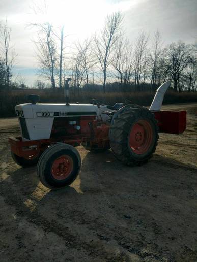

Pictures aren't good so can't tell much. It has the later 4/49 engine, hydrostatic steering... The front weights are a nice bonus($3-500)
It has been prettied up. Repaint, seat, front lights aren't original housings.
Rear tires appear to be original 45 degree Goodyears, good indication of low usage tractor if they are. See where they were made, if English or French made they likely are.
If hydraulic oil is milky, that is the source of the slow. Cheap and easy fix.

Thanks for the info guys. I will probably try to take a look at this tractor in person this coming week. Other than verifying if the tires are original, what else should I look for?
The guy who has the tractor did say he repainted the tins. Said he hasn't used it that much at all in the 3 years he has owned it. Bought it from the original owner.
What would make you turn around and walk away? Ie..what major ossues should i be looking for? I am mechanically inclined but am not looking for a huge project at this time. I have two very young sons.

Another photo.....

If it starts good, steers and shifts good and the brakes actually work, the rest is pretty much just changing out fluids I'd bet. Great tractor, very, very well built. Parts are 100X easier to get now than even 10 years ago. Tires are going to be the big thing. If the rears are in good shape, that's great. If they are getting bald and cracked, that's going to be an expensive replacement. And check the electricals! If it charges and the gauges and lights work, that's good. They use a Lucas electrical system and it's just not what most people in the US are familiar with. It can cause some major head scratching.
