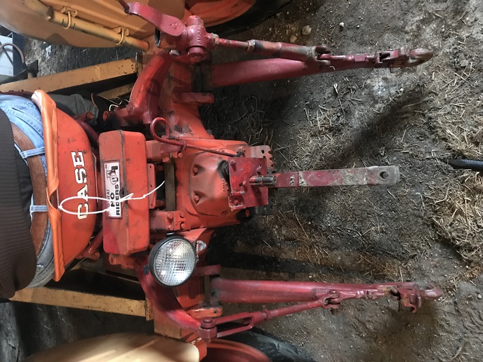

What can you guys tell me about the 200 B--H? Whats it worth? Is it industrial or a
farm tractor? Looks like a nice straight tractor. Runs good.

Being that this 200B has a PTO and eagle hitch the lever on the left hand side of the transmission is most likely a hand clutch.
If this tractor runs right and fits your budget, you should buy it.

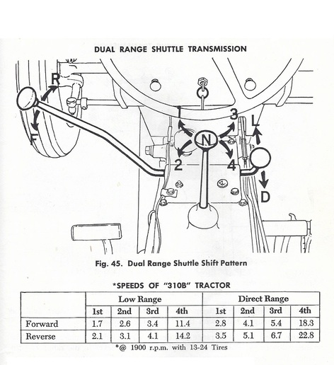

PostPosted: Mon Jan 01, 2018 11:23 am    Post subject: Re: New Find Reply to specific post Reply with quote
The lever is too high for a hand clutch unless modified someway. Appears to be a shuttle fwd-rev lever like in this 310B dual shuttle tractor pic.
The tractor has fixed rear axle, fixed HD front axle with cylinder type power steering. Someone has changed the grill decal slant "200" to horizontal "210". I have seen 210B with pto but not Eagle hitch although it was a factory option.

PostPosted: Mon Jan 01, 2018 11:41 am    Post subject: Re: New Find Reply to specific post Reply with quote
That lever on the left is a dual range shuttle shift. It is a foot clutch. It does have some sort of power steering. It was bitterly cold so I did not run it. However, it only has one way cylinders on the main loader so it is gravity down. Can that be changed? Can a blade, or disk or cultivator or even mower be added to the eagle hitch? Does it need to be converted to 3 point? It is a cute little tractor! Not sure I need it but I sure want it!!! Smile

mnbryan, you found a very nice example of a 210B with a model 21 loader in what appears to be good condition. The shuttle transmission and power steering make it very desirable IMHO. There were 359 210Bs made during 1958 (162) & 1959 (197).
You could convert the main cylinders on the loader to dual action, but I would not recommend doing so for two reasons. First, the unit was designed for use in the current configuration. The hydraulic capacity of these little tractors is not what you might expect with modern tractors. They were rated at 9 GPH when new. Aux pumps (with up to 19 gpm service) were available and used when a backhoe and loader with dual action cylinders where attached.
The second reason I would not change it...is the tractor appears to be a very good example of an unmolested 210B with a 21 loader. Anything you do to modify it will reduce it's value IMHO.
The eagle hitch is essentially a category 1 setup that will allow you to connect to most category 1 implements. I don't see the top link, but they are not that hard to find if you ultimately need one.
What's it worth.... If the engine, clutch, transmission and hydraulics are in good working condition I would be a buyer between $2000-$2500. In excellent condition maybe as high as $3500. Any mechanical issues...well you'll never buy it cheap enough to fix all issues and get your money back, but that may not be what will motivate all buyers. - Joe
