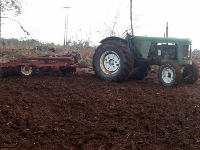

I moved it about a week ago. Parked it pointing uphill. Clutch is out of adjustment but worked fine. I took the frontend loader off and went to move it. It won't go into gear. Got it in gear but can't get it stop. Clutch must be froze. Hope it's just cold froze.

Well it could be from ice so running it for say 30 plus minutes should warm it up and thaw it out. But it could also be a bad throw out bearing like the one I did not long ago on an 8N Ford where the throw out bearing froze up and ate the pressure plate fingers

I win today. Jabbed the brakes several times with the clutch depressed.

Once in a while a guy gets lucky. On the 8N ford I had to put a new clutch in the guy was using it and pushed the clutch down to stop it and it just kept going so he shut it off. Throw out bearing was so badly locked up that the pressure plate fingers show they had gotten real hot and also got ground away by the bad bearing
