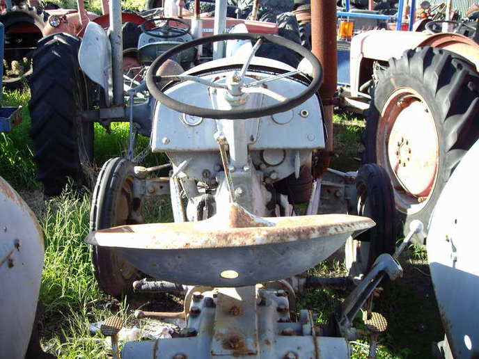

I believe- others will know for certain- UK built TE's didn't have amp meters, they have the red jewel lamp on the lower right- you called it an ignition light? I think there were 2 large holes for temp and oil, 2 small for red jewel and light switch, and the key is below the dash from factory. So many were 'customized' over the last 60 or 70 years... Tom's has the average 'customized' look.
My Canadian market TEA-20-85 is just like Charles'. The one in the bone yard must be a very early model.

As there is an air vent in your panel Kaesark then the tractor is a later post 1951/2 model with 12 volt wiring . All TEA/D 20 tractors came with the hole for the temperature gauge already punched out but only the TED had the gauge fitted at the factory . In the interests of authenticity many owners remove gauges fitted later to TEA tractors and often have difficulty finding the right blanking plate to cover the hole . To fit a gauge to a TEA you will also need a new thermostat housing to accommodate the temperature sensor.
So TEA on oil pressure gauge , TED oil and temperature gauges .
Lights were often retro fitted by owners using their own bits and pieces or a Ferguson kit . The factory kit came with a template for drilling the light switch which was a simple Lucas push/pull one or two position on / off . One position for headlights the other for rear plough light . Use push pull types , toggle switches will turn on and off as your hand brushes them while steering , very annoying . The white knob on the dash of my TED is the light switch , it is not quite in the exact position it should be but is within a half inch or so from the factory specification ,the hole was already there so I used it . The two holes in your tractor's dash are probably for switches also , lights forward , rear , work light and horn were all controlled from this area .
The red light is the charge light , it shows the state of charge from the dynamo as well as acting as an ignition on light . Turn on ignition and the light should glow , at slow idle when insufficient charge is reaching the battery it will also glow , at full charge during high idle or work it will turn off . It will also act as a warning light if the fan belt breaks or there is an electrical fault .
