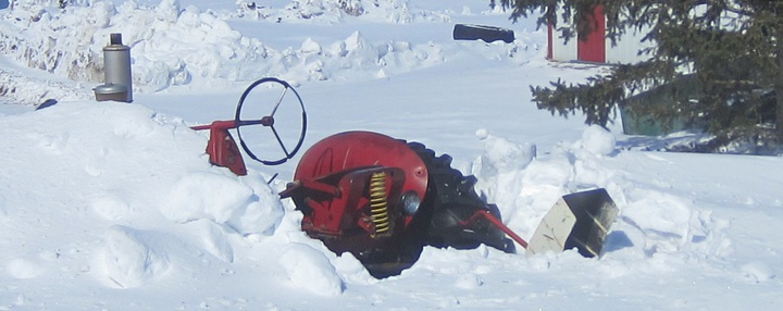

Your biggest problem is the useless "pull-type" snowblower.
Those are only good if you don't get more than a few inches of fluff. Otherwise you are struggling through big snow drifts, beaching the tractor, trying to pull this thing through.
All chains will do is ensure you get even more stuck, quicker. The problem is clearance under the belly of the tractor. You can only go through snow so deep before the tractor gets high-centered on the snow. Once the belly of the tractor is sitting on enough snow the wheels can't touch the ground, can't get any traction, and you're STUCK, whether you have chains or not.
Effective snow removal in any appreciable snowfall requires the tractor to be BEHIND the snow removal implement, on cleared ground.

BarnyardEngineering wrote:
(quoted from post at 11:28:42 01/03/1Cool Once the belly of the tractor is sitting on enough snow the wheels can't touch the ground, can't get any traction, and you're STUCK, whether you have chains or not.
That was my first thought too. In a serious winter snow accumulation I would not have much hope with the Cockshutt 40 and a pull type blower. But my "push type" rear mount blower has been getting the job done for the past 40 years without tire chains. If it gets a little too heavy pushing on ice I just use the hydraulics to put a little of the blower's weight on the tractor which makes a big difference in traction right there. I'm sure tire chains will add some traction to any tractor but I've never owned a set of chains and have no plans to buy them.
https://youtu.be/w3If1uIg7hA

rusty6 wrote:
(quoted from post at 12:21:10 01/03/1Cool
Famous last words LOL. It does help not to have hills....looks like you are flat enough if you stood on a tuna can you could see the back of your head Very Happy Very Happy

Holy Snow Cow!
Do you ever wish you had a power unit for that blower where you were inside a heated cab and was facing the thrower as you drove it FORWARD??
You must have weightlifter neck muscles, LOL.

Hey Barnyard Engineering, How did you get a picture of my 8n and Erskine snow blower? Cool I have had mine since about 1972 and it was built in about 1948 or so. My dad bought a new one in 1950 and my serial # is lower. I have blown more snow than I can imagine after living in Minnesota and now South Dakota. If you know its capabilities and limits it will work for many, many years with little or no maintenance except greasing. In the 30+ years my dad had his he only replaced the pillow block bearing housing once, bearing was fine. On mine, I removed the fan several years ago to straighten the fins and then balanced it so it spins beautifully.
