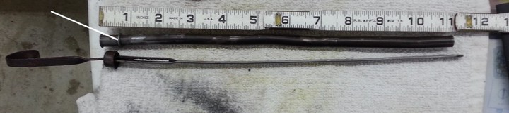

Does anybody have an 850 gasser nearby them and could measure the tube that the dipstick goes in? I think someone changed out my tube to a longer one, not allowing the dipstick to get anywhere close to the oil level. My tube is 9.25" exposed from block to tip but the dipstick is only 11.125". Thanks in advance.

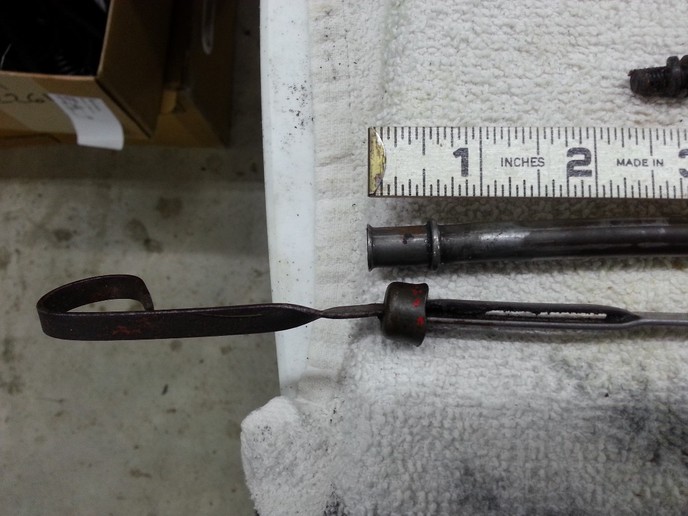

Here are a couple of pics I just took of the parts in my pile
of stuff. Is your tube tapped all the way down? The part #
is EAf 6784A.

Well I can't see what your tube length is from the pic but it looks like the sticks are the same length. Do you happen to know what the installed length is for the tube?

PostPosted: Sun Jan 07, 2018 6:00 pm    Post subject: Re: Need help on an 850 dipstick question. Reply to specific post Reply with quote
The tube is 11-1/4" long, only 5/8 of an inch should be
sticking out of the block where the flange stops it.

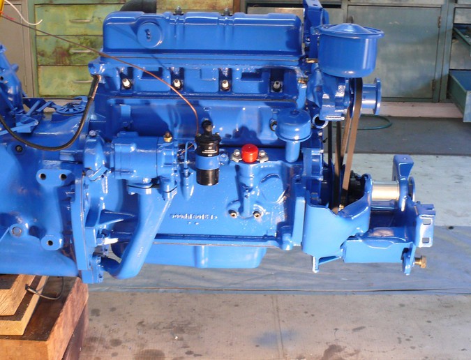

[quote="Off Road SHO"](quoted from post at 18:23:00 01/07/1Cool [quote=
Here is one I am rebuilding. As you can see, the tube is not
sticking out much at all.

PostPosted: Mon Jan 08, 2018 12:14 am    Post subject: Re: Need help on an 850 dipstick question. Reply to specific post Reply with quote
Off Road SHO wrote:
Here is one I am rebuilding. As you can see, the tube is not sticking out much at all.
OSB, looking good!!! Appears to be a 62-64 tractor, will you please provide the paint brand and code you used?

PostPosted: Mon Jan 08, 2018 1:18 am    Post subject: Re: Need help on an 850 dipstick question. Reply to specific post Reply with quote
Looks very nice.
Nice to see wood cribbing under it too.
Jack stands give me the creeps.

PostPosted: Mon Jan 08, 2018 6:13 pm    Post subject: Re: Need help on an 850 dipstick question. Reply to specific post Reply with quote
Thanks Old SeaBee. My tube doesn't have the lip, it's just a straight tube.
I like the blue, is that Corporate Ford Blue?
I'll cut off my tube but I need to know how far the dipstick needs to reach down into the pan before I do.

PostPosted: Mon Jan 08, 2018 6:39 pm    Post subject: Re: Need help on an 850 dipstick question. Reply to specific post Reply with quote
Parts site says it was 11.25 inches long. Earlier ones 10.47.
How much was inside and how much was outside, it doesn't say.
I have to get my 960 out this week so I can measure the outside
when I do. If the earlier ones, EAF-6784-B, have the same length
outside, I have a new old stock one here.

PostPosted: Tue Jan 09, 2018 3:31 pm    Post subject: Re: Need help on an 850 dipstick question. Reply to specific post Reply with quote
The NOS ones I have won't work.
On my 960 the tube protrudes 9/16 of an inch. Just the
length from the lip to the top that OldSeaBee showed.
The dipstick itself is 11 1/4 inches from tip to the top of the cap.

PostPosted: Tue Jan 09, 2018 3:51 pm    Post subject: Re: Need help on an 850 dipstick question. Reply to specific post Reply with quote
I have a lot of different colors in rattle cans. I just spray some on scrap metal and pick what like and take it to the paint store and have them mix up some good enamel and then mix it with some hardener. I am in no way close to being a painter and my eyesight is going south with having macular degeneration.
It is just going to be a work tractor but after doing all the mechanical work on it I thought I would try and make it look
better than what is was when I started on it. As far as the original factory colors go I don’t really care. I think the Ford Guy that came up with that Buff color must have been a new Daddy and he liked the color of those new born diapers.
The Blue color I picked was Rust-Oleum ford blue engine enamel 248945. The Enamel they mixed might be a shade off.
The loader and sheet metal are Extreme Yellow with gloss hardener. I am still working on the sheet metal. This is a 64- 4130. That my story and I’m sticking
to it.
