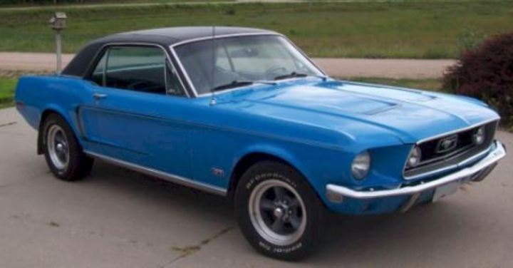

Dean, I believe this is the info you are looking for:
Early Ford Tractor Blue Paint Codes
Ford - WT8002
Ditzler/PPG - 13582
DuPont - 6544
Martin Senour - 10158
Sherwin Williams - J5-1825
The early Ford tractor paint color was also used on the 1968 Ford Mustang. Paint code WT8002 also known as Sierra Blue.

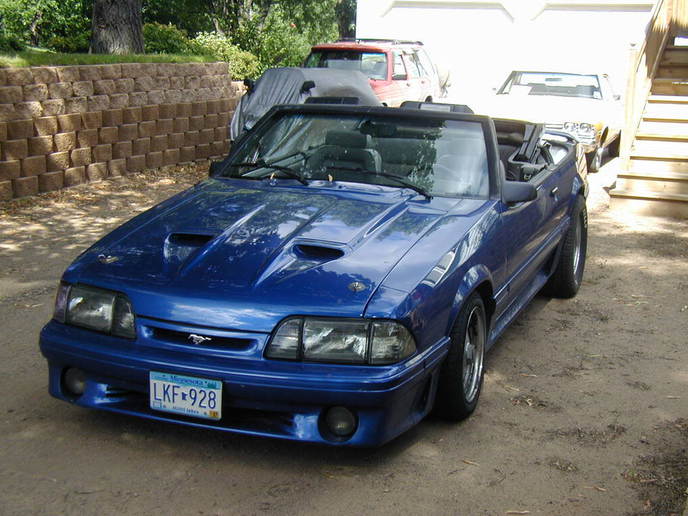

Hmmm, I painted my Mustang, 2005 GMC Sierra Blue
Pat

PostPosted: Fri Jan 12, 2018 10:34 pm    Post subject: Re: Ford blue paint code Reply to specific post Reply with quote
You painted a Ford with a Chevy color - Blasphemy! Very Happy
Interesting that GM and Ford have a paint with the same name.
Nice looking Stang!
