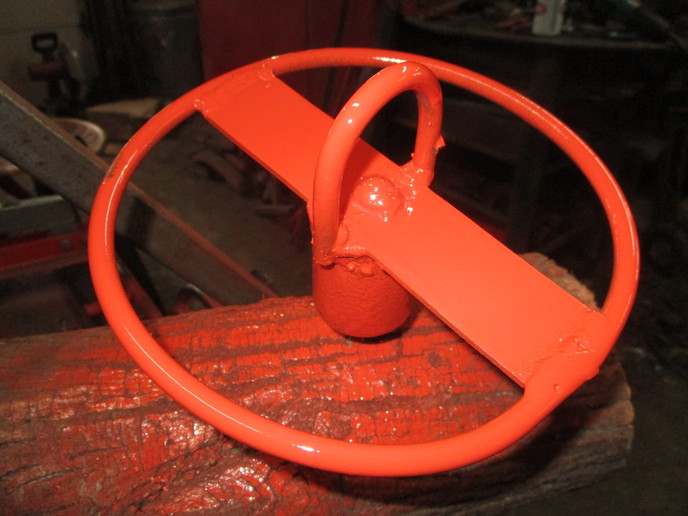

Been surfing the U tube mornings, waiting for the shop to warm up.
Some one posted a couple of videos of this tool, I have no idea if it is in commercial production or not.
I thought it had maybe some potential to work in my operation so I spent an hour and made one.
This is my version. The wheel is just a piece of 5/16" rod, 8" diameter from a Kubota crate, along with the flat strap, and hoop for cable hook. Welded a piece of 1-1/2" ID of exhaust pipe for a spacer to reinforce the grip of the "Scorpion" pole barn screw so it couldn't bend and break off.
Screw it into a block to be split and pull it to the splitter, With my jib pole and winch, and lift it up onto the bed. I have had to drag big uneven blocks with my grapple, if they were hard to roll, but it sometimes unhooks and takes a while to get a big awkward block up onto the splitter.
The video makes it look fast and easy, but time will tell when I put it to use next spring when I start cutting firewood again.
What do you guys think we ought to call it??? other than a waste of time. lol.

As I stated, I do have a grapple, but sometimes it unhooks when dragging a big awkward block to, and up on the splitter. I think tongs will do the same. If the blocks are round, I just roll them to the splitter. I have also used a choker made with 1/4" chain also, which works pretty good.
Besides, those commercial wood tongs aren't cheap, and I am. HeHe.
If I had to step out and buy all commercially built toys for cutting firewood, it would be cheaper to buy oil. Baily's wants $129.oo for a pickaroon. Mine cost me a piece of used pipe and some metal scraps to make. It is much more satisfying to build something out of nothing that fulfills a need and make work easier. Us old farts have to be smarter than the block of wood in this case. If not the block of wood will beat the He!! out of you.

I tried a 1/4" lag screw that I had, and it didn't want to thread in very well. The Scorpion, has a sharp self starting drill point.
