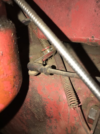

I can't seem to get the linkage adjusted right. Set max throttle @ full with the stop adjustment, then the throttle will not go all the way to the minimum.
Once I start then engine and, just breath on throttle lever it goes to full speed.
This is my second new governor the first one the saddle was loose on the shaft and the connection to the proof cable started to spinning in the governor shaft, hence meter quit working.
CAN ANYONE POINT ME THE IN RIGHT DIRECTION Idea

I have already fixed the poor construction; knob for linkage to big for linkage ends have ground down to fit; penetrating lock-tight in the sleeve for proof cable.
Sims are ok, the balls are the same weight.
I need to know what the measurement is for the bend of the throttle arm "long one" not the linkage, but the arm on the governor.
Shocked somebody must know

Several times I have seen people connect the throttle rod to the wrong governor lever. The one with the spring is the one to connect to. Carb goes to
the little sort lever.

PostPosted: Sat Jan 13, 2018 7:59 am    Post subject: Re: new 8n governor will not govern. Reply to specific post Reply with quote
Here's a picture of mine. Shiny part in front is the proofmeter
cable. Governor compensating spring below the linkage.

PostPosted: Sat Jan 13, 2018 9:00 am    Post subject: Re: new 8n governor will not govern. Reply to specific post Reply with quote
Thanx for the pic.
What function does that throttle compensating spring provide, I do not have one, never did, could that have my problem all along???

PostPosted: Sat Jan 13, 2018 9:27 am    Post subject: Re: new 8n governor will not govern. Reply to specific post Reply with quote
msgtusafret wrote:
(quoted from post at 11:00:50 01/13/1Cool
Thanx for the pic.
Mine when I did not have the spring the throttle lever would not stay up, the gov would push the lever down. That is why it is called the governor compensating spring.

PostPosted: Sat Jan 13, 2018 9:34 am    Post subject: Re: new 8n governor will not govern. Reply to specific post Reply with quote
Strange, that's not my problem....It's really cold out there but I put one on and see what changes thanx

PostPosted: Sat Jan 13, 2018 10:55 am    Post subject: Re: new 8n governor will not govern. Reply to specific post Reply with quote
Disconnect the end at the governor, the one from the front hand throttle and make sure it moves fairly easy. should really only feel the bumps on the plate.
