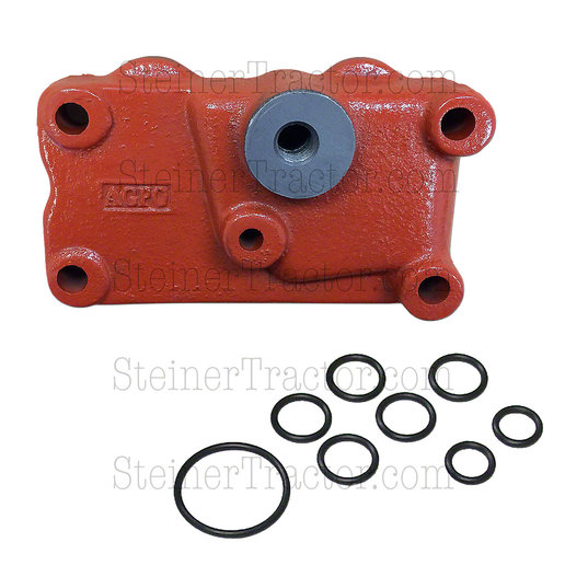

Anyone know much about these "FDS457 Hydraulic Valve Adapter Kits" sold on various tractor parts sites? Wanting to add single acting cylinder capability on my 651 tractor to operate a hydraulic arm hoist that I built, but don't want to have to chain the three-point lift down every time I go to use it. I have an open center valve for it already. I used this hoist on my Jubilee tractor, but it already had an adapter plate on it. Can't swap the adapter because they are different.
Adapter block
Cover plate

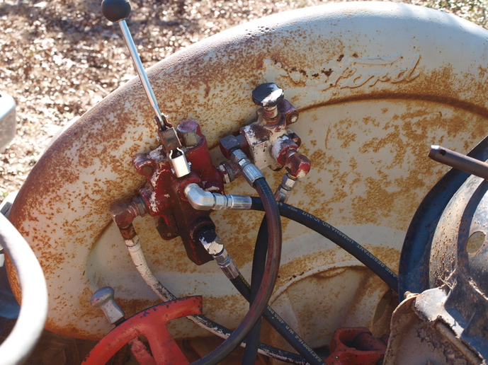

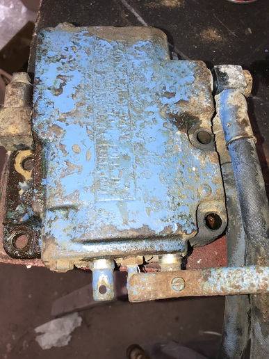

Why not just add a remote valve instead of the adapter?
They come up on eBay or CraigsList pretty regular.
Always on eBay new, but pricey. There are many different styles.
The one you have for a Jubilee, if like this first pic, fetch a premium.
So does the dual valve in the second picture. The third is Tisco
and works fine. The Jubilee valve will fit the 651 with an adapter
plate. I recently sold the one pictured with the adapter to fit a x01.

I found the adapter in my first picture for about $50. I already have the valve I can mount on the fender where it's handy to operate. I found out this plate with the valve I have will let me use my hoist and still use the 3-point as long as I don't try to use both at the same time. That will work for me. I think this will be my cheapest, easiest route to go. One of those valves you show would be nice, but everyone seems to want a fortune for the used ones they want to sell on ebay. Thanks for the input.

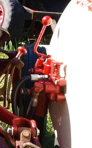

This is the valve I am using on the Jubilee that I will move to the 651 with the adapter plate. I won't need the diverter valve on it anymore.

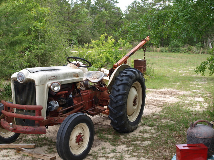

Finally got this all together. Used the manual diverter vales. One way cycles the fluid out of the adapter plate and back in the plate. Other position runs the fluid through my control valve to the hoist cylinder and open center return to a fitting in the filler cap. Each lift is now independent of the other. Three point will stay where I leave it and the hoist will stay where I leave it. Works perfectly. Will try to put up some pictures of it all tomorrow. This is the hoist that is now hooked up on the 651. This Jubilee now has my minie-backhoe and soon my 703 front end loader going on it. The Jubilee will be a dedicated Tractor Loader Backhoe.

How is that hoist attached to the back of the tractor? Why not just use a boom pole on the 3 point arms?
Back to top
View user's profile
Hdonly
Regular
Joined: 04 Aug 2017
Posts: 97
Location: Florida
Report to Moderator
PostPosted: Tue Jan 30, 2018 8:43 am    Post subject: Re: Ford 651 hydraulics Reply to specific post Reply with quote
I have much more control with this hoist. It will go lower and lift higher than a boom pole. Plus I still can raise and lower the three point while the hoist holds position. Helps when picking things off a flatbed truck.
