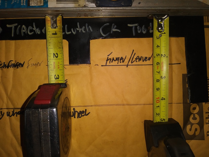

I am with showcrop lets take the guess out of it... The tool don't know were I got the measurements to make it, here are somewhere else dunno... You don't need it tho...
Tool
No need to have a tool use a straight edge and do the math it still works out to 2". Turn tapes around tho... The last time I studied math 2 1/4" from 4 1/4" twuzz 2"...

PostPosted: Thu Feb 22, 2018 6:38 pm    Post subject: Re: Clutch pedal has no tension Reply to specific post Reply with quote
Just by looking at it I can tell its not 2 inches. But I will get measurements tomorrow. Thanks for the pics!

PostPosted: Fri Feb 23, 2018 3:31 pm    Post subject: Re: Clutch pedal has no tension Reply to specific post Reply with quote
1.88 is the measurement. 2 3/4s minus 7/8s if my math is right

PostPosted: Fri Feb 23, 2018 4:41 pm    Post subject: Re: Clutch pedal has no tension Reply to specific post Reply with quote
1-7/8" a typo I recon...
1/8" is BIG.... The total travel is around 3/8" (my guess)...
