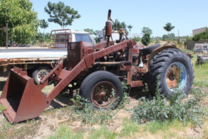

I got this tractor off my uncle, he bought it new, it has done a terrific amount of work, I have had it for over forty years.
Amongst other things, after the dozers went through, he cleared over 4000 acres with this machine
Sometimes getting up to four punctures a day and that is with cover tires
This was in the sixtys
Being a farmer and not to clued, maintenance was close to zero
The fuel pump seized up twice to my knowledge, lack of oil
The front axle is not standard, it came off a international crane, the original axle housing broke
The engine is now us, needs rebuilding.
Its been a wonderful machine
Standard tires in Australia are 18.4 28
12v is standard
The long lever by your left foot is to engage the PTO and hydraulics if I remember correctly
hydraulics are live
The PTO is then engaged and disengaged by the lever at the rear but if the lever by your left foot Is not engaged the PTO will not drive
The lever by your left knee is the starter
cant get the photo to load, its on there but isnt loading

Those are the wrong rear wheels on it, they should be white and dished different.
I will have to look for the blade, haven’t seen it in a while

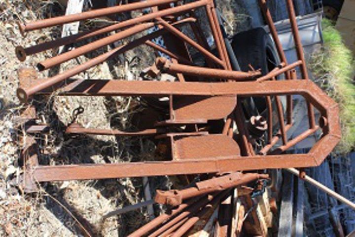

went looking for the blade, didnt find it but i did find the frame.
the frame is attached to the three point linkage.
to lift the blade, you lift the three point linkage.

Wow there's a whole lot of history there with that boy. Looks like he could use a full restore as well. I like the way that tire fits with that Fender where you can still get a fist in between there. My tire is way too tight on the fender. The one thing I like about the tractor that I have is all the sheet metal I don't think there's one dent anywhere. I just really don't have much use for a tractor I just would love to do the work and restore it and I can use it to drag my driveway.
